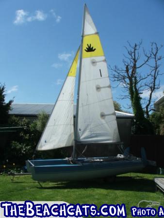

  • Just acquired a Hydra, old. Rough. Fixed her up. Sailed her twice - dream.
    I want some more info regards the Hydra. Particularly about rigging. It has no traps, I'm going to rig some up myself. Is there a set way for the Hydra? If not, I was thinking of running a shock cord from a block on the side stay, up and through the front beam and across to the other side. As there are no attachment points on the hull, and I can't get it under the tramp.

  • Not my boat, but the Hydra:
    http://www.seabreeze.com.au/img/photos/other/6580398.jpg

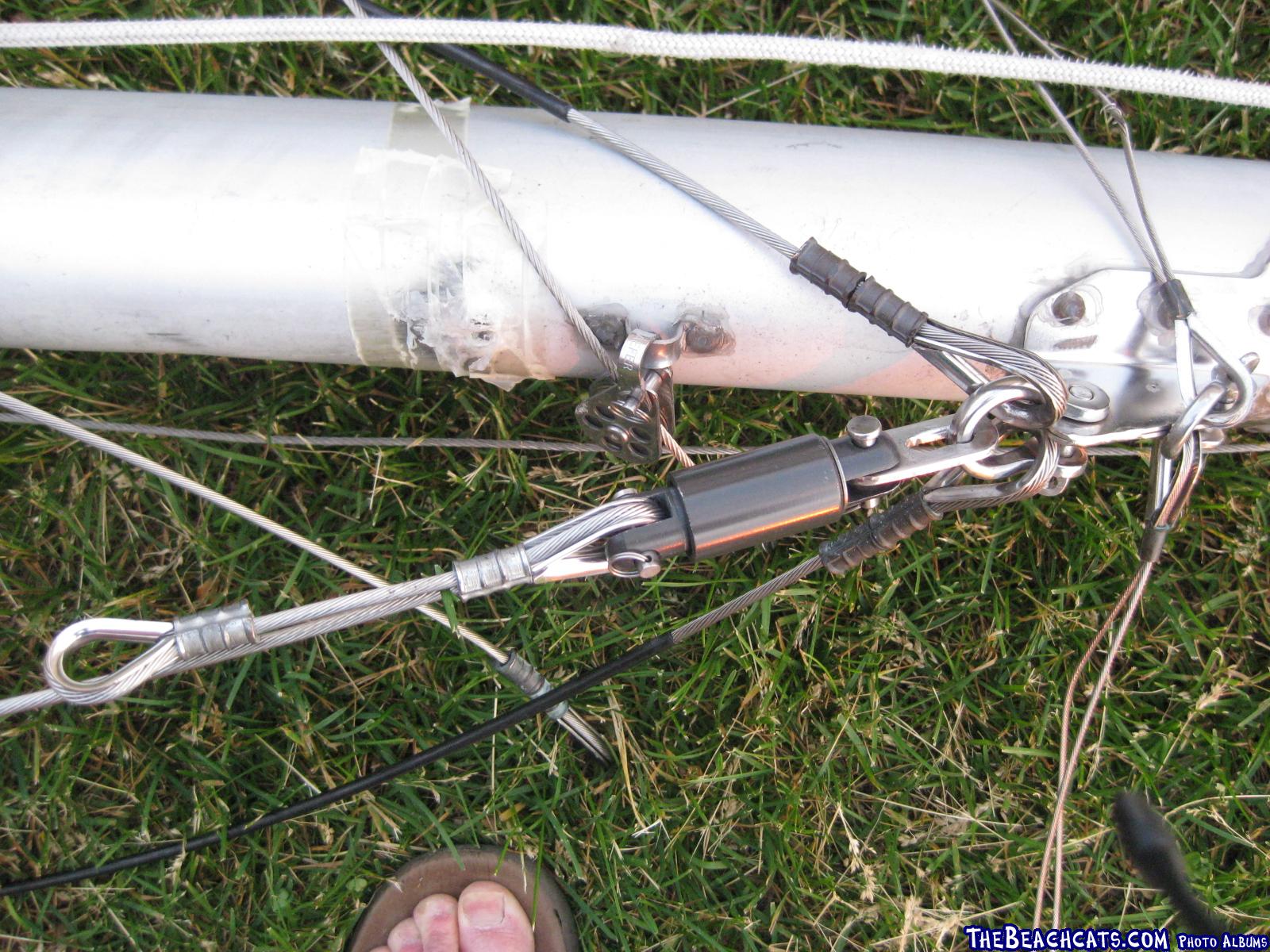

    I assume you have a way figured to attach the the trap lines up near the mast hound? Many boats use a hound with double attach points, one for the forestay/shrouds, & another, slightly higher for the trap lines. This photo is from my Nacra 5.7. The trap lines are the upper wires. It uses 2 wires each side as it has double traps. (Clicking on many photos in posts will enlarge them to full size)
    http://www.thebeachcats.com/gallery2/main.php?g2_view=core.DownloadItem&g2_itemId=88318&g2_serialNumber=3
    In your case, since you can't go through the tramp, (without adding grommets), use the front beam. I use 1/4" bungee through the beam for the front trap, with a plastic snap on each end, just where it exits the beam. This makes it easy to unclip from the actual trap line & prevents the bungee from snaking inside the beam. Try to make the holes you drill in the beam end caps smooth, or insert a plastic grommet, otherwise you wear the bungee pretty quick.

  • Your boat looks good, congratulations.
    The reason why the trap wires are attached higher is to allow you to move forward and aft the side stay while out on the trap, but it will still work if attached at the same point, if you find room.

  • DamonLinkousI've never seen the Hydra before, do you have pictures of the sails and any logos? Any literature or manuals?]
    I've updated the Hydra album with a few recent photos.
    http://www.thebeachcats.c…ctures/?g2_itemId=107201
