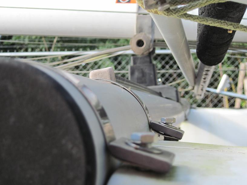

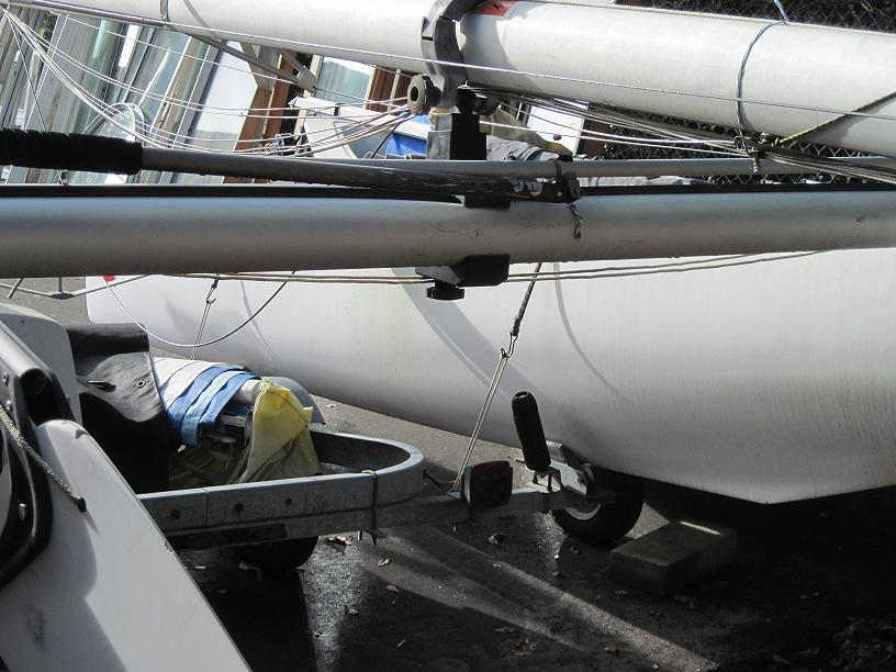

    First off, the gentleman responded to my dent inquiry with these words:
    The crossbeam, at the location of the mast fitting, looks as if someone put it in a vise and squeezed it down to 3-1/2 " high rather than the 4" it should be. Most of the distortion is on the top, and it returns to a round x-section within about a foot either way (strictly naked eye estimates, but I did put a tape on it to get the 3-1/2" reading). There does look to be a very slight bend in the crossbeam, but it's hard to see. Without the fittings, it would be easier to measure.
    *** Link to album added by admin ***
    http://thebeachcats.com/pictures/?g2_itemId=106159
    He provided the following pictures: http://www.thebeachcats.com/gallery2/main.php?g2_view=core.DownloadItem&g2_itemId=106161&g2_serialNumber=3
    http://www.thebeachcats.com/gallery2/main.php?g2_view=core.DownloadItem&g2_itemId=106166&g2_serialNumber=4
    http://www.thebeachcats.com/gallery2/main.php?g2_view=core.DownloadItem&g2_itemId=106168&g2_serialNumber=3
  • adlertThe crossbeam, at the location of the mast fitting, looks as if someone put it in a vise and squeezed it down to 3-1/2 " high rather than the 4" it should be. Most of the distortion is on the top,
    Looks and sounds like a mast was dropped on the crossbar. (or a pine tree...)
    Not the first time that has happened to anyone.
    If it was a mast, the force required to squish that beam could have severely folded the mast to an unusable state.
    Is the existing mast OK?
    The owner at the time could have replaced just the mast, hoping that the traveler track would still be usable.
  • The little I can see of the boat looks OK, heck it still has end caps on the beam,& the covers on the end of the mast spreader bars look good. If the rest is in that good of shape, buy it, NOW, before Damon sees the light & runs out & steals it.(He won't admit it, but secretly he wants a 5.7)
    It's hard to see in the photos, but the traveler track looks OK, unless there is a kink in it. If it is a gentle bend, it will most likely pull straight when bolted to another beam. Buy the cheapest rear beam you can find, if it comes with track, so much the better.(if track is kinked look for abeam with track) You can see a few of the countersunk bolts that hold the track on. Underneath each one there is a hole drilled in the beam that will accept a socket(5/16"IRC, you will need a 4" extension). They are self locking SS nuts. There will be a couple of screws that hold the beam cap in place.
    When you go to slide the car off ALL THE BEARINGS WILL FALL OUT, unless you have a car loader to slide the car onto.
    I suggest remove the beam, turn it upside down, remove the end stop, then slide the car off. If you don't have the plastic car loader when you go to re-assemble, put the bearings into the car, then squirt shave cream or toothpaste into the races. That will keep the bearings in place while you slide the car on the track, & will wash out first time in the water.
    That track is the HArken Small Boat non captive bearing track. The car does not show up in the photos, if it's toast, you need to find a non CB car. I have one, but I'm reluctant to sell it, as it didn't roll as smoothly as it should when we removed it. I'm not sure if it only needs new bearings & end caps, or if the races are worn from sand. If you get in a bind I can send it to you, use it til you find another.
    The beam straps appear to be loose. I can see daylight between strap & top of beam. The little chips between the strap & bolt may not always go flush against the hull, but those look to loose.
    Notice the rubber grommets that go against the hull are missing. Just fold a bit of inner tube in two, & punch a 5/15" hole for the bolt, or use any such rubber material you have handy.
