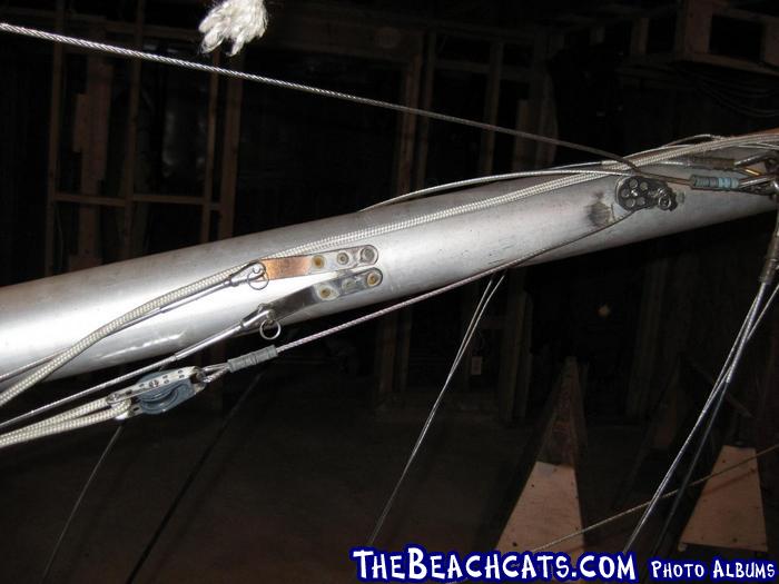

    From your post,(block to block), it seems you have the original 3:1 system. Jib halyard goes around the wire block attached to the mast, then down the mast, with a block-with becket? Looks like this?
    http://www.thebeachcats.com/gallery2/main.php?g2_view=core.DownloadItem&g2_itemId=74274&g2_serialNumber=6
    Block attached to wire halyard, line portion of halyard attached to becket. You pull on the long line, the tail tied to the becket is about 3'?
    If your jib is tacked down near the bridal/forestay connection, & you can't tension it, there are only about 3 possibilities.
    From your description, it seems that the jib is tacked low, the right size,(not to long), and the head of the jib is not jamming up against the wire block on mast, which might occur if jib was wrong size.
    Once you hoist the jib, you need about 8" between the block on the wire halyard & the cheek block on the mast. If you don't have that space, you don't have room to tension the jib, as the top block moves down with tension. Perhaps the wire portion is from another boat, & to long, dangling the block-w-becket nearly at the cheek block on mast?
    The easy fix is go to a West Marine, snip off the block, cut off a short section,then using the same thimble swage the block back on. Total cost, under $2, they let you use the swager for free, just buy the swage fittings.
    Before you do that look at the really simple things. Is the bowline tieing the rope portion to the becket snug? It seems obvious, but if the loop is 6" long, that can be regained by re-tieing. Notice on my photo the loop is quite long. In my case it doesn't matter as the cheek block is near the foot of the mast, & the wire portion short enough that there is close to 18" between the two blocks.
    If you were thinking of ditching the wire halyard, it is simple to just tie the new line where you need it. When going to roller furling, I changed the wire to Spyderline.
    The only caveat about shortening the wire line is it needs to be long enough so the shackle that attaches to the jib head does not end up to high. Otherwise you will need a ladder to stand on in order to attach the jib to the shackle.
