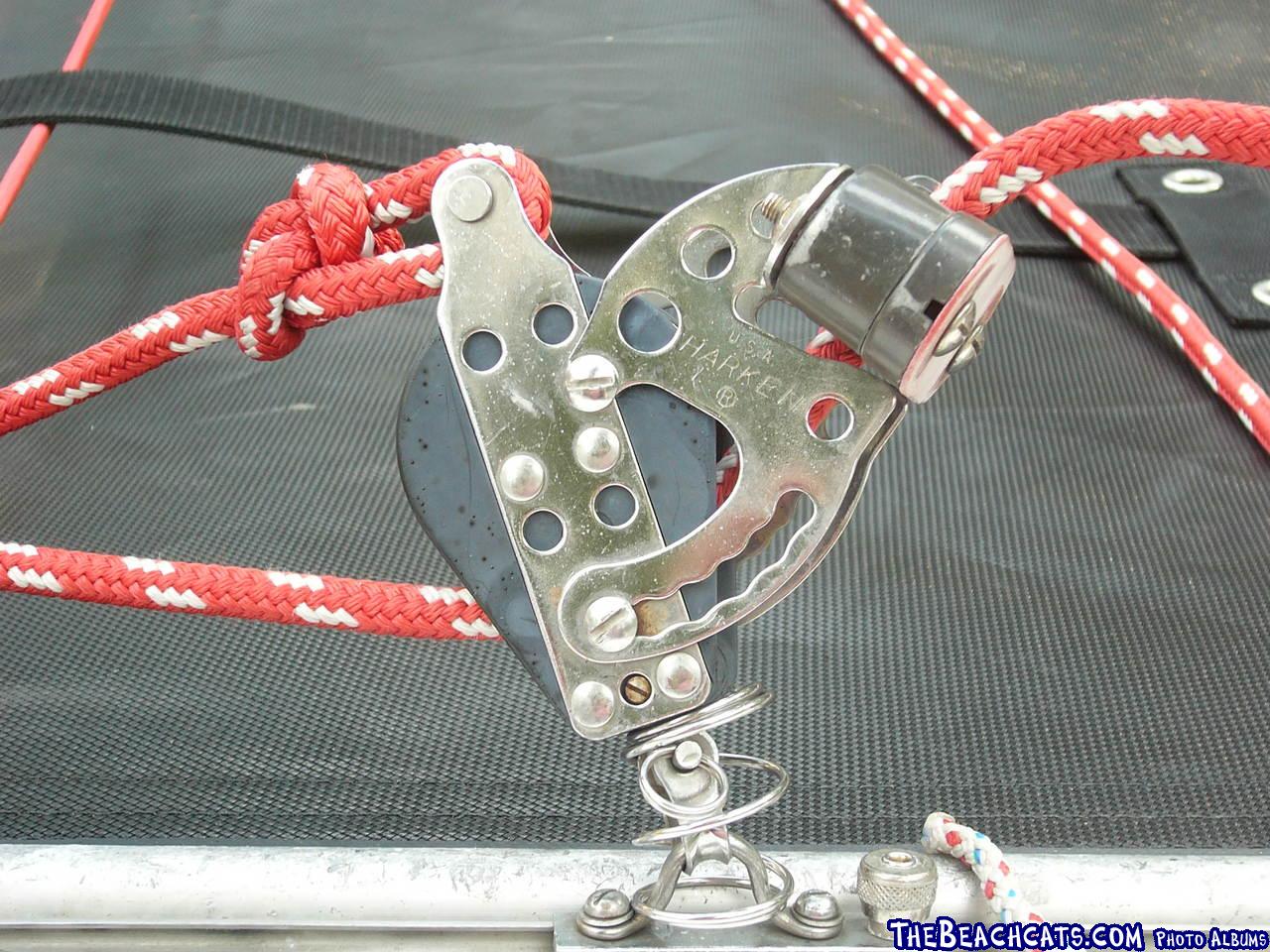

1 Wife had great difficulty uncleating the Harkins on the jib sheet, I can't see a way to adjust the cleat angle any more to allow the line to release easier ?

Jib cleats can sometimes be tricky, for sure. Few things:
The larger the line, the easier to uncleat. I like hi-tech 5/16" lines for my mainsheet, which I really only cleat when under spin, but for my jib sheet I like 5/16" sta set, as it's the smallest line I can make work properly. 1/4" is almost impossible to uncleat b/c of hte diameter, and sta-set will absorb water, which makes it easier to 'pop' because of the heft, if that makes sense. I don't know what you have, but if you were to go to 3/8" new sta-set for the jib sheet, provided the cleats are turned up as far as possible, I doubt she'd have to much trouble at all, as long as she is trying to whip/pop the line out of the cleat.

Don't try to pull the sheet in a linear motion, against the force holding it. Yank the sheet directly upwards,(or downwards, depending on which way the cleats are mounted). If pulled at 90* to the load on the line, the sheet will move out of the cleat jaws fairly easily.

Jib cleats - (are at full up adjustment currently, pretty sure it's 5/16 line) I can whip the sheet down, and release the sheet from my position easily, but from the front it appears the sheet to trampoline clearance only allows for a small angle to whip the line out of the cleat. Any harm in turning the harken other side up? So the sheet is whipped up to release?

Do this and it will fix your problem. Reverse the cleat. I have been preaching it for years. Gives you a much more favorable sheeting angle and makes the release very easy under high load.
http://www.thebeachcats.c…ictures/?g2_itemId=18431
