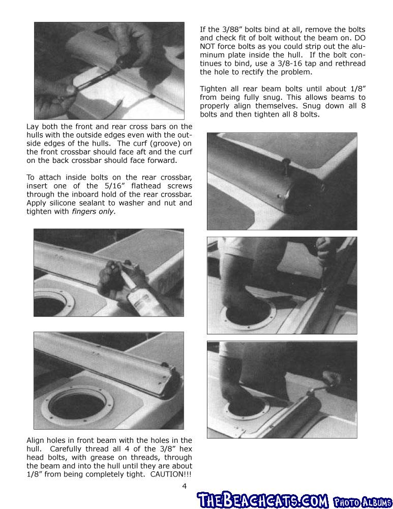

    I need to connect my beams and mast of a prindle 18.2 ..
    Who knows the correct way ?

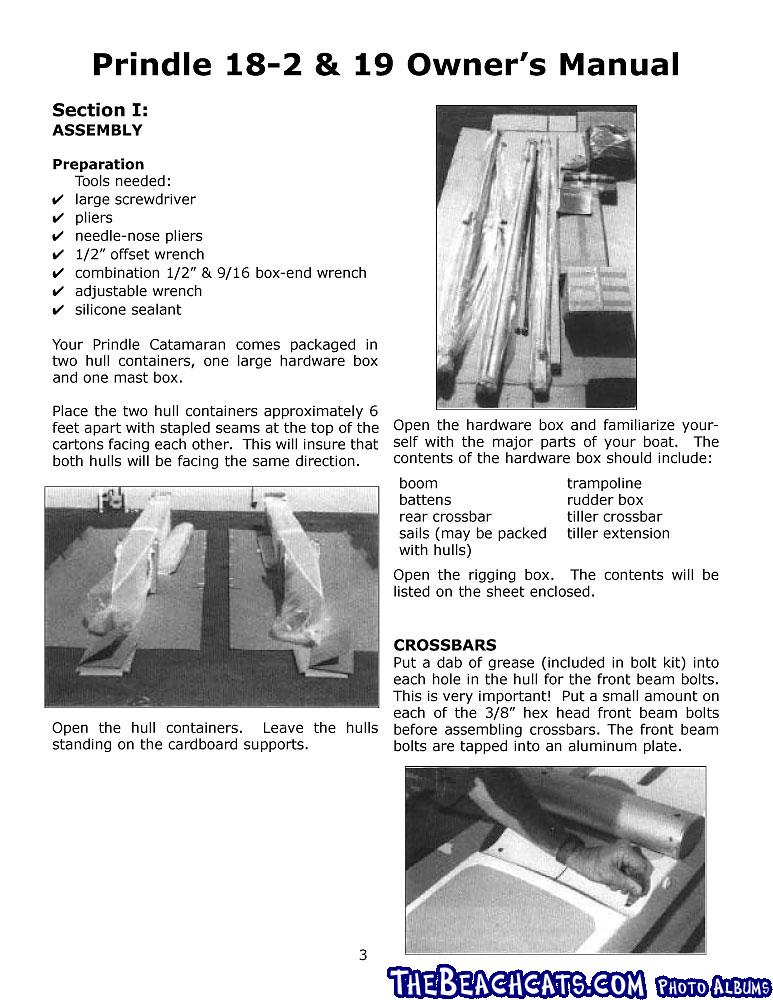

    Karel,
    Welcome to TheBeachcats.com!
    There is a Prindle 18-2 assembly manual available here.
    http://www.thebeachcats.c…ictures/?g2_itemId=35451
    Hopefully that will clear things up. Did you get the boat disassembled? Where are you located?
    http://www.thebeachcats.com/gallery2/main.php?g2_view=core.DownloadItem&g2_itemId=35465&g2_serialNumber=4 http://www.thebeachcats.com/gallery2/main.php?g2_view=core.DownloadItem&g2_itemId=35469&g2_serialNumber=4
  • Thanks for the manuel,
    Yes it was disassembled,
    In Belgium Sint-Idesbald www.kyc.be
    Please I want to know how long the screw bolt need to be..
    Karel

  • Front beam bolts are 4 1/8" (x 2.54 for cm) long. I couldn't loosen rear bolts (slotted ones go inside for traveler clearance). Pete
