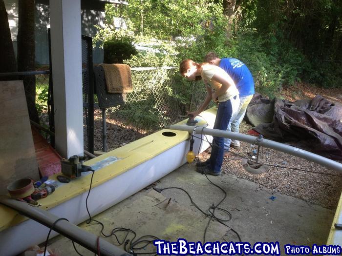

    Ok both hulls are finished with the injection and vacuum pressing and they are rock hard. I have the crew sanding today and then tomorrow I will be filling any holes left and any other imperfections on the deck. So far pleased with the results, but as with any old boat she will never be perfect but she will be strong.
