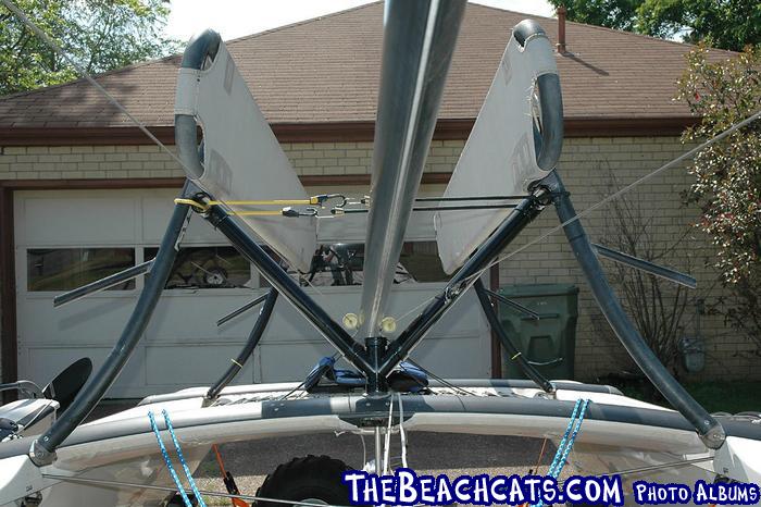

    When you got the wings did you get all the mounting hardware including the plates that rivet to the beams? Originally for the Magnum wings the wings just used slugs in the trampoline slots, but they had a bad habit of pulling out of the slot.
    You are going to need some kind of support for your wings when folded. Here's a simple set I built from a quick trip to the hardware store out of PVC pieces.
    http://www.thebeachcats.c…ictures/?g2_itemId=11711
    http://www.thebeachcats.com/gallery2/main.php?g2_view=core.DownloadItem&g2_itemId=11734&g2_serialNumber=7
  • Great info on the 81 hulls being tanks, so should I even bother with any extra glass?
    Using the re enforcement plates couldn't be a bad idea on the stern cross beam right?
    Yes I got all the proper mounting gear with the boat, I did have to replace one of the mounts but they are all riveted to the beams and look good.
    I made a wing mount all most exactly like the one pictured, I think I used that pic for my model.
