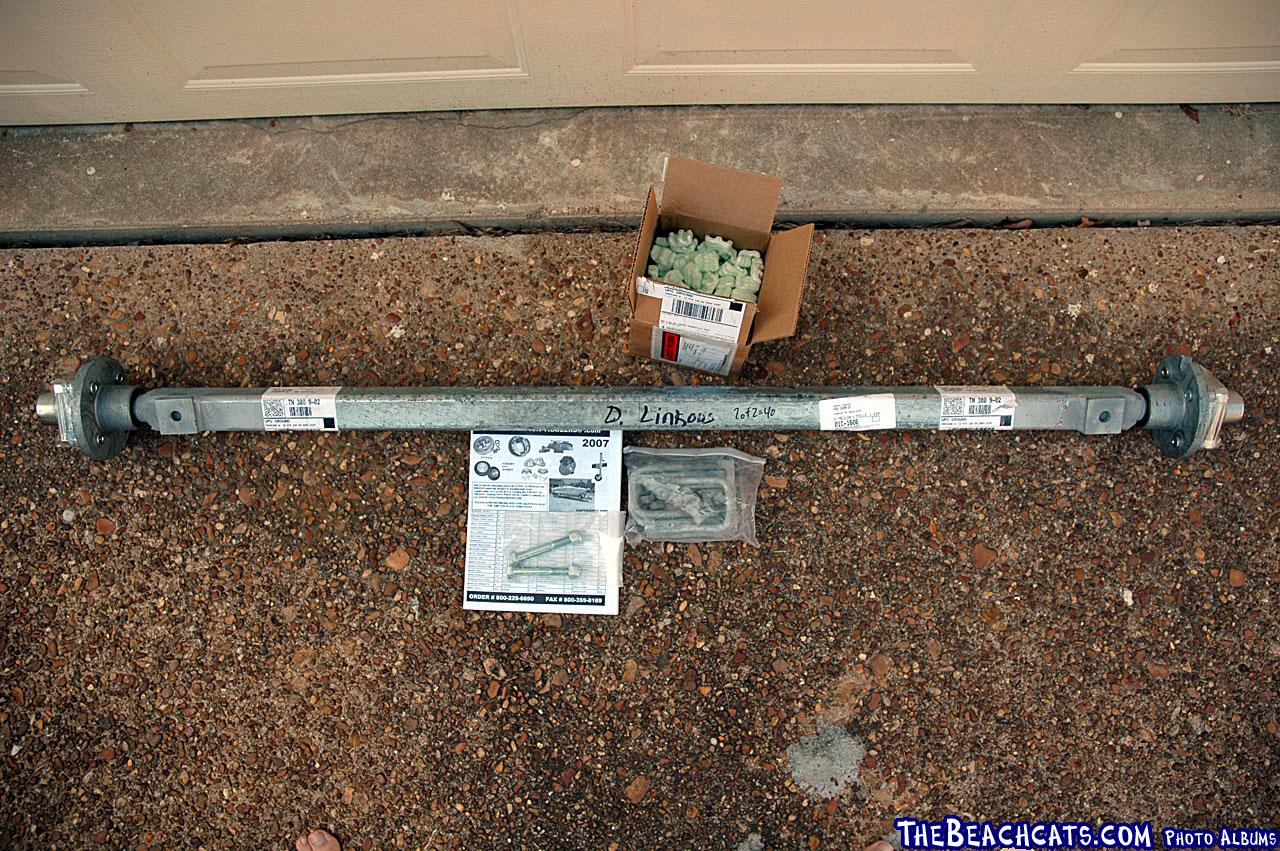

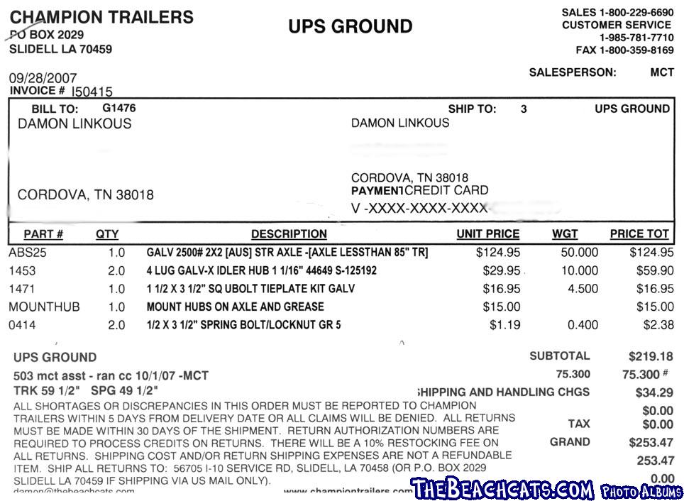

    When I burned up a hub/spindle on my Magic Marine trailer I replaced the entire axle-spindle-hub assembly with one rated for 2500 lbs and included grease fittings on ends of the spindles so the hubs can be repacked without removing anything.
    The entire thing was shipped already assembled and it just bolted on. It was custom made by Champion Trailers based on measurements I gave them.
    The axles that come with trailers are generally rated for the minimum, I like having the extra margin since most of my road trips are 400 miles plus. Also, keep good tires!

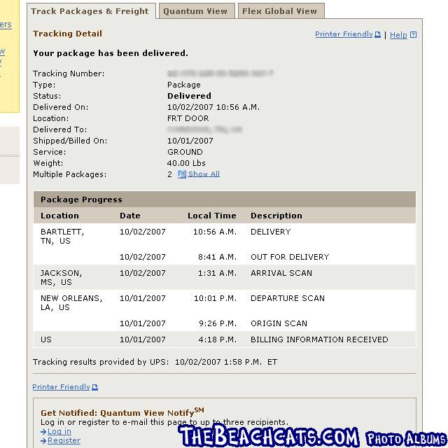

  • 75 lbs... under $35 in shipping ?
    WOW
  • MN375 lbs... under $35 in shipping ?
    WOW
    Actually the whole experience with Champion Trailers in Slidell Louisiana was a "WOW".
    I called them with my measurements at 11:00am Monday and they built the axle/hubs assembly, gave it to UPS that evening and UPS dropped it on my doorstep around 11:00am on Tuesday.
    WOW!
    Looks like prices have gone up a little since 2007 but here's the one I bought, love the "Spindle Lube" setup.
    http://www.shopchampiontr…RINGS/productinfo/ABS25/
    http://www.thebeachcats.com/gallery2/main.php?g2_view=core.DownloadItem&g2_itemId=35153&g2_serialNumber=4
