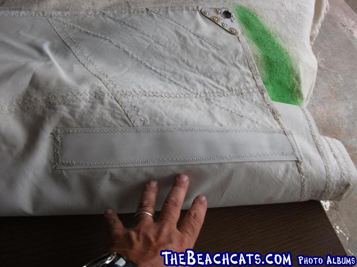

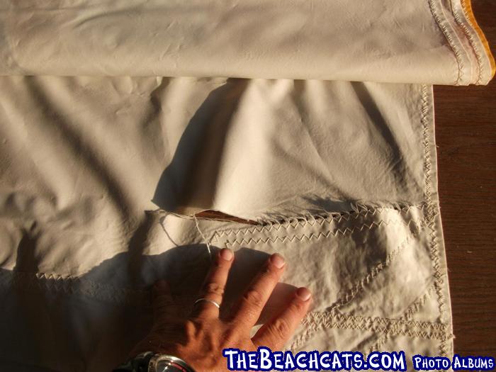

Does anybody have experience with "patching" sails? Is this a possible DIY project or are all sail repairs best done by a pro? I have 2 tears in my main after a meeting with a pine tree this weekend (might post video later). One is about the lenght of my palm the other the length of my arm. Any suggestions?

defiantly possible to do yourself. I have had a few dozen repairs over the years. Mostly fixed by friends of mine who have sewing skills.
A very strong sewing machine (professional grade) is best
I had a gf who was a seamstress and she did a bolt rope repair for one of my sails that was 50x better than any repair i had done at a sail shop.
What material are you talking? (dacron, mylar, pentex, etc) -

Not sure of the material. It's the original sail from my '77 Nacra.

you need some material, proper thread, needle(for machine or hand), 1/4" basting tape(really helps,double sided sticky tape)...
really nice if you have a machine, needs to do big zigzag pattern, or stitch by hand(takes a while on big repairs). dacron of cours, sailrite carries all these things. gets you back on the water faster and way cheaper!

Hey Gray, I'm down the road from you and have had repairs done a couple of ways. One way was by Joe Waters of Waters Sails in Lexington. He actually fixed my Viper Jib for free once (VERY small repair). Of course with a sail the age of yours he will probably recommend a new sail, he is a sail maker. The other Way was at a local business that makes covers/tarps. I bought some Dacron and had the guy there use it for the repair. I was specific and showed him EXACTLY what I wanted him to do. It turned out pretty good and he only charged me like $30.

If you just want a quick fix to get back on the water then stick a piece of sail tape on both sides
and go have fun. If you have a machine strong enough then sew it zig zag with v69 thread and it will be good to go. I have done this quite a bit.

I did end up taking it to Joe (he is a very nice guy). I remembered he put a zipper in my jib a while back. He also said he use to sail a Nacra and it had the exact same main. I felt inclined to have a pro do it after I looked at it again. The long tear is along a batten pocket. He is going to rebuild that pocket as part of the repair. I might have tackled this as a DIY project if it weren't for the location of that rip.
