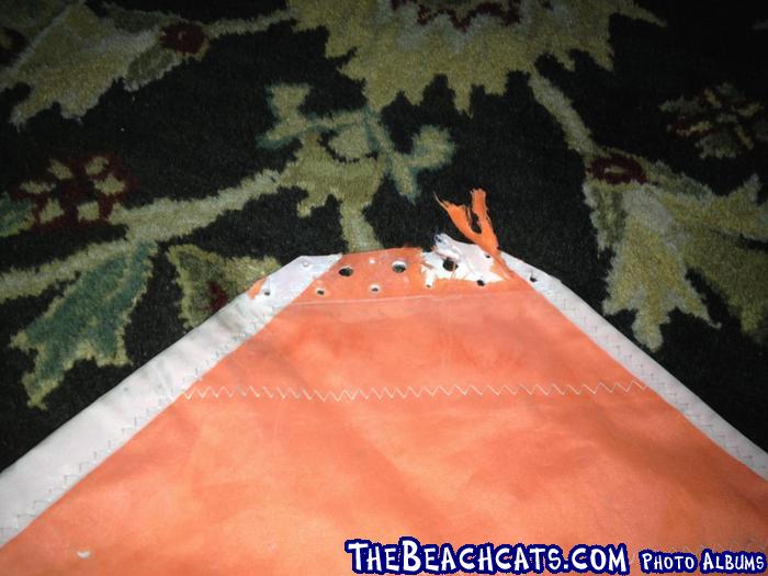

  • We were sailing in the sierra mountains this weekend and had very strong winds while some rain swept in. We were having a great time until the clew plates ripped from our jib. On the lake we just rolled up the jib and then sailed with just the main for a while before bringing it home. Now it is time to assess the damage and figure out what it takes to put it back together again.
    http://www.thebeachcats.com/gallery2/main.php?g2_view=core.DownloadItem&g2_itemId=88945&g2_serialNumber=4
    I've checked Murray's and a new set of plates and rivets is pretty cheap so I'm going to do that. Before I hit buy on the order though, I'm wondering if anyone has any suggestions for how to reinforce the sail before I put the plates on and anything else I should put in the order.

  • Andrew, I'm not sure it was his sail that let go. Looking closely at the photo, only one hole is torn out, that would be where the blocks were attached. The rivets did not pull through the material. It looks like the rivets let go, leaving the jibs full load on the single hole where the blocks attached.
    A brand new sail cannot take that load on a single point, so it rips through.
    In a strong wind the clew plate stays straight, but it doesn't want to, it wants to conform to the bend in the sail. The rivets are then required to hold a tension load, trying to separate the two halves of the clew plate. A rivet normally is designed to mostly hold a shear load. Centre peened usually fail from the rear side when exposed to tension, looking at them you can see how little material is on the back side.
    I had the same thing happen on an N5.7 mainsail. They used centre peened rivets, & the rear of the rivets were corroded from salt/age. The sail itself had seen fairly light use.

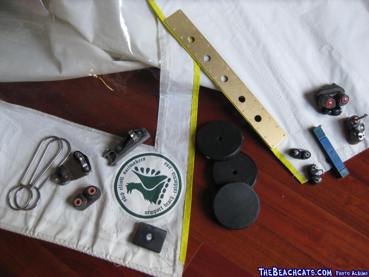

    http://www.thebeachcats.com/gallery2/main.php?g2_view=core.DownloadItem&g2_itemId=81202&g2_serialNumber=4
    I heard the rivets letting go, as soon as that happened the hook on the main tore through the material.

    In my case both plates fell on the tramp & were saved.

  • Andrew,
    The sails are definitely old, but given it is just the boys and I out playing around on the lake, the fact that we don't get max performance from them I don't believe has been an issue for us. New sails are in my future, but I've been hoping to put that off a while longer. Not that I'm against a good excuse icon_smile
    Chris,
    I looked at the plates when I got home tonight, it is definitely the rivets that failed. There is a good deal of corrosion on the plates, and all the rivets that are left are missing their backside. The sail itself has 2 tears, one from the jib sheet block and one rivet hole, the rest of the holes are intact.
    I'm thinking some sail tape, new clew plate and rivets then hopefully that gets me a couple more trips to the lake this summer/fall and then maybe new sails for Christmas.
