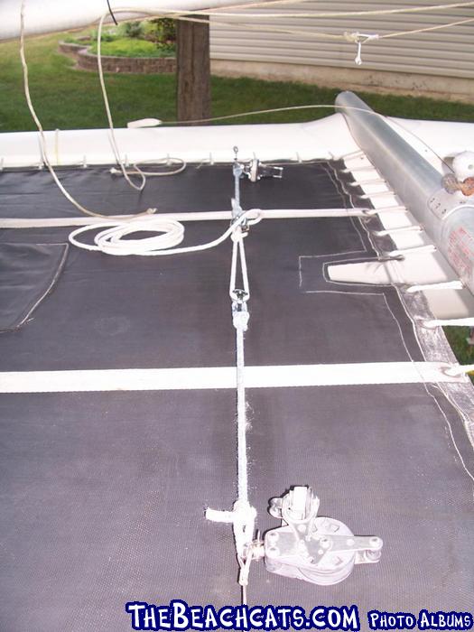

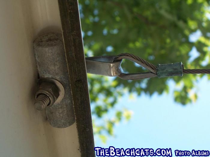

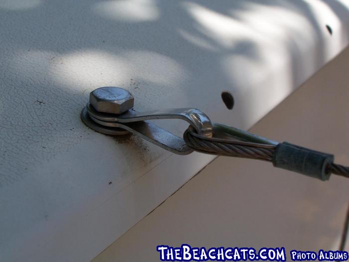

  • Does anyone know the length of the pigtail wires for the jib blocks. I want to rig the barber hauler system. There are photos on page 10 and 11 of the manual, the appear to be about midway between the inboard side of the deck and the hiking strap.
  • pull to pull, my pigtail wires measure 7.5 inches, the pigtail anchors are situated 13.75 inches back from the center beam.
