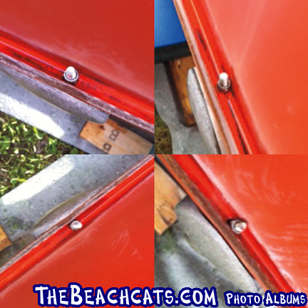

Turned the 1976 P16 over to do some sanding on someone lousy epoxy job and got an scary surprise.
What's wrong with this picture?

Ya but look all all the built up suspension.....
Ok here is the real picture

I don't get it, what am I looking at?
- Registered: Mar 20, 2012
- Last visit: Jun 16, 2014
- Posts: 248
Looks like a part is missing.

That's scary! You sailed like this?
*edit* well actually the beams are fastened with 4 bolts on each beam. How stiff is your platform? (IYKWIM)

isn't there supposed to be an alloy tube between the nut and gunnel lip
to spread the rigging loads
and stop the nut being pulled through the glass? -

Yes there is, the rod/rube is threaded so you don't need a nut.

SS load spreader backing rod is GONE! I've got a bunch of extras if you need em.

These are from under the deck lip where the Beams connect.
No I have not sailed it. I also found some soft spots on the inner section of each hull at about the beam area. So I may have to put this one on the back-burner for a while. I was hoping to get it into the water first because everything else looked so good until I turner it over.
Instead I may be making a franken boat out of the good hulls on the other to P16s in my back yard to try to get one on the water this year.
DING DING DING ! WINNER, WINNER, Chicken Dinner!
There are load spreaders still at the shrouds just not the beams.

ah yes, now can see the beams under the lip
can also see black fretting corrosion marks under the lip where the stainless bar sat for years....
