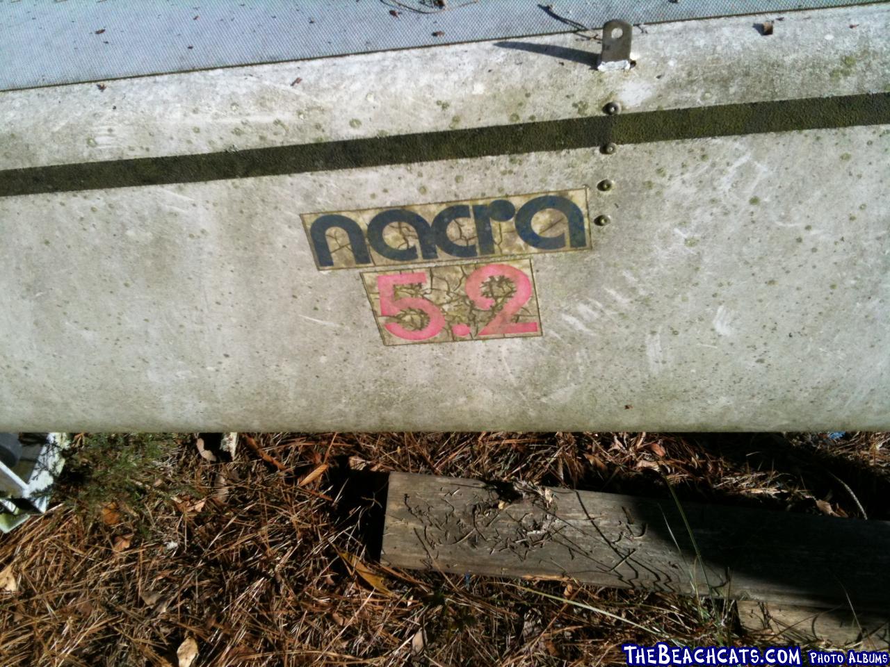

  • Does anybody have a source for this older decal?
    http://www.thebeachcats.com/gallery2/main.php?g2_view=core.DownloadItem&g2_itemId=71679&g2_serialNumber=3

  • I have vector files for 2 versions of the decals.. You can take them to a sign shop to have them produced. I had a request for a set last week but have been to busy to get them out to him. ( sailed sat and Sun !!),, PM me with a email address and I will get them out this week for you both.. Cheers Hal

  • i had decals made for my 18 square by taking a picture of a nacra 5.2 decal off my computer and texted the picture and the dimentions for it with 18 square instead of 5.2. to a decal maker with my credit card info. and a few days later i had my decals. you can have them made larger or smaller than the ones in the picture as well as your choice of colors.

  • Gray, can you confirm that it is a single decal, in that shape? It looks like the older decal, (they were a single line, NACRA 5.2) was cut in two pieces, with the 5.2 being placed below NACRA.
    ERICE, from Japan sent Wolfman & myself a bunch of the old classic decal, in either red or blue.
    PM me an email address, when I leave the lakehouse I will take a digital photo of the decals & send it to you. If they are what you are looking for, I'll send you a couple.

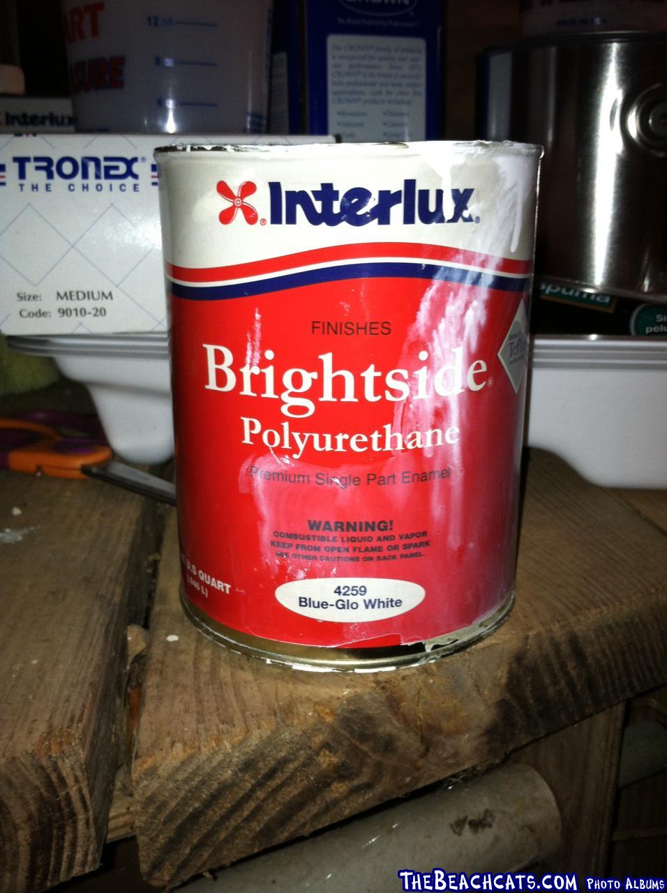

  • Gary
    Your hulls look GREAT! what did you use to paint them with? did you brush & roll or spray?
    I am about to paint my boat and have not decided on what paint to use.

  • Thanks Jeff.
    A good buddy of mine taught me the "roll and tip" method. We sanded the hulls with 80 grit paper, fixed a couple spots with 610 epoxy and painted with a thin foam roller followed by smoothing out with the "tip" of a brush. We used the paint below with ~10-20% penetrol added.
    http://www.thebeachcats.com/gallery2/main.php?g2_view=core.DownloadItem&g2_itemId=87082&g2_serialNumber=3

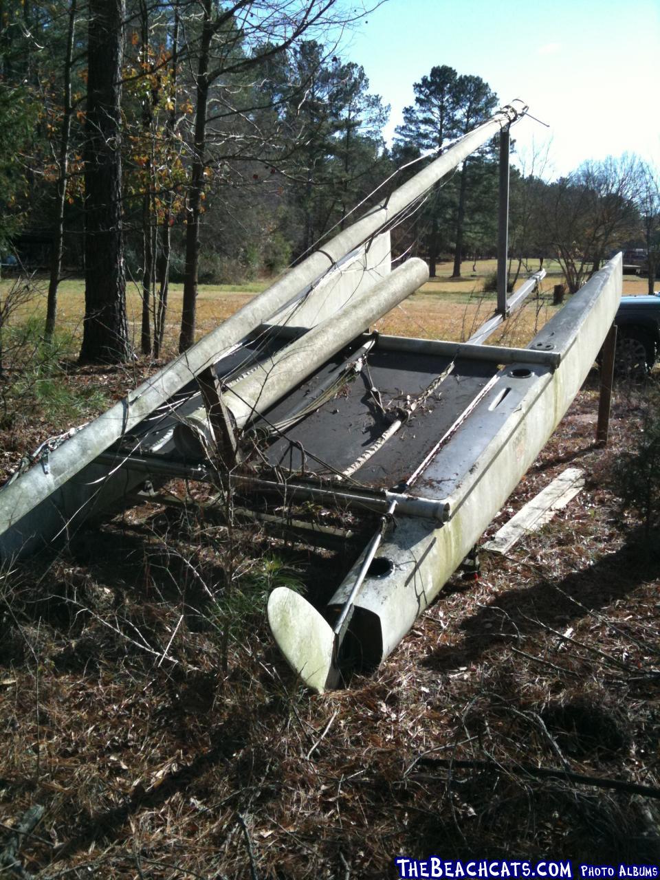

    Here is the before image:
    http://www.thebeachcats.com/gallery2/main.php?g2_view=core.DownloadItem&g2_itemId=71678&g2_serialNumber=3

  • Ed,
    It looked like what you described, a single decal cut and placed as in the pic. I would be very greatful if you have an extra set laying around. I pm'ed you my email address. Thanks.
