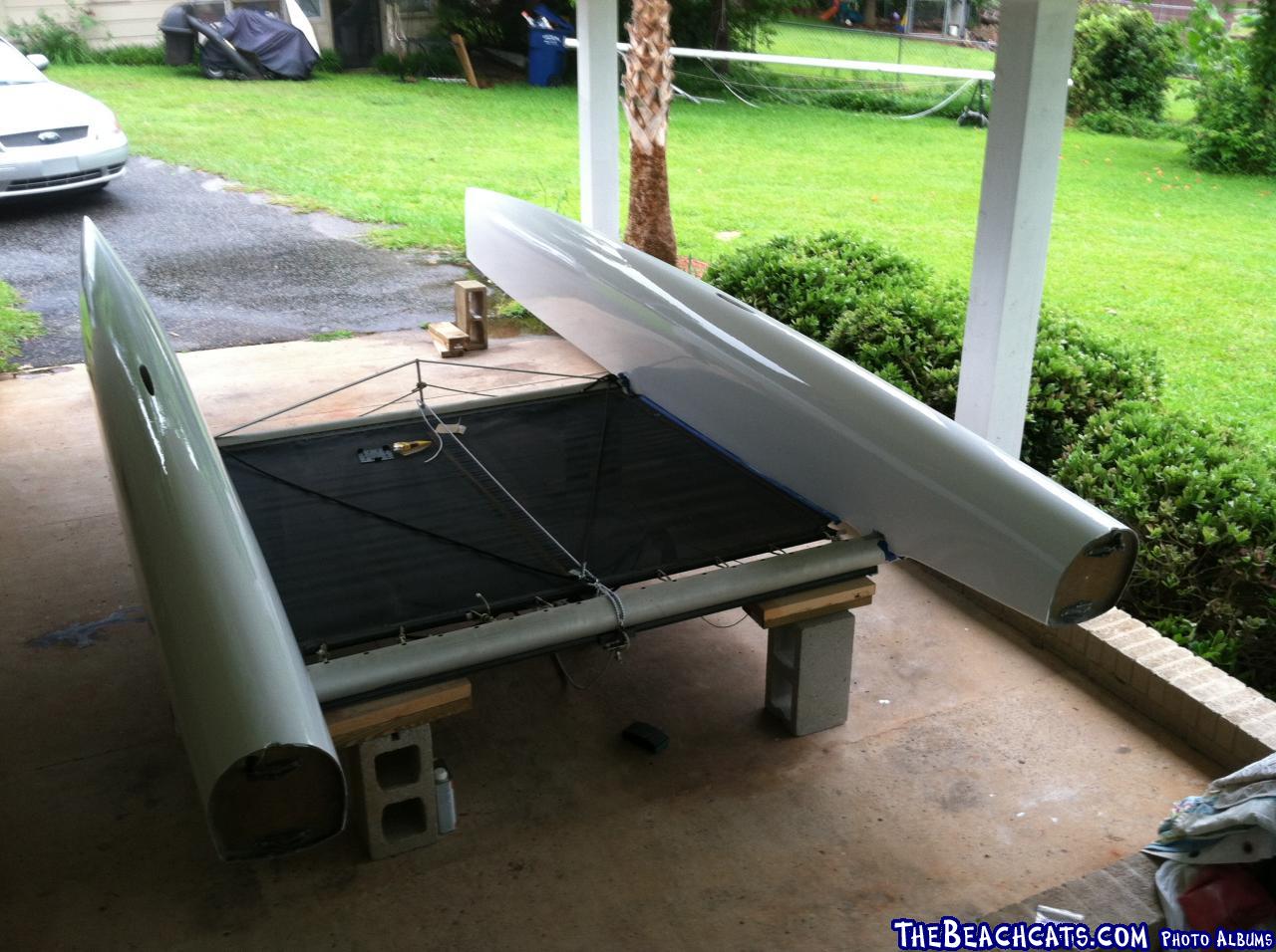

  • I used "roll and tip" as well. Just finished bottoms.
    http://www.thebeachcats.com/gallery2/main.php?g2_view=core.DownloadItem&g2_itemId=87059&g2_serialNumber=3
