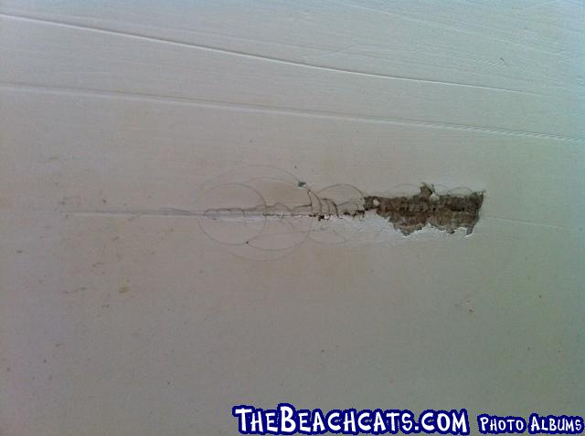

    This the only one I very worried about. it is very low on the bottom just a few inches in from the keel on the curved inside of the hull.
    http://www.thebeachcats.com/gallery2/main.php?g2_view=core.DownloadItem&g2_itemId=83777&g2_serialNumber=3
    Bur I am also gonna do a bottom job soon as well.

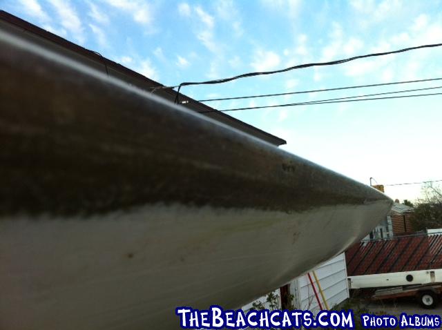

  • So if I wanted to lay down a wear trip on my 5.2 (no damage just worn) Can I use the 3M filler and sand or would I do better laying down 2 cloth strips and fiberglassing.
    Nacra 5.2
  • golfdad75So if I wanted to lay down a wear trip on my 5.2 (no damage just worn) Can I use the 3M filler and sand or would I do better laying down 2 cloth strips and fiberglassing.
    Where is the wear strip going?
  • On the bottom of the hulls. Between where it sits on the rollers.
    Nacra 5.2
  • Are there any fibers coming through?
    If it it we me I would build it up using cloth and West Systems or any other brand of resin..
  • On mine you can see in the pic above that pretty much all the gelcoat is worn off of the center section of the keels.

  • QuoteThis the only one I very worried about.
    Dustin, can you reach that hole from a hatch? If so that is a very easy fix. You can see that the integrity of the hull is compromised to the left of the obvious damage. If it can be reached from inside just wipe it with acetone to get rid of any gunk that might affect bonding. Cut out 3 layers of cloth, severl inches larger than the damaged area, stack them & wet out. Reach inside & slap them into place, then gently smooth them out, obviously latex gloves are in order. You will now have strength in the hull, & backing.
    Once they set use an angle grinder & carefully grind away the damaged gel coat & fibres from the front side, going no deeper than just so as to touch the patch you put inside. Taper the area you grind, then cut, wet out & place 2 layers of cloth on from the outside. Try to use as little resin as possible, just enough to wet the cloth. You want the final layer to sit 1/8" below the side of the hull. This will give you some room to apply gel coat. If you are not going to gel coat the repair, give light hand sand to smooth things out, then finger wipe a thin resin layer on top to seal any fibres that may have been exposed by sanding, and level the patch with the hull.
    You can buy a small gel coat repair kit for about $15. that little area will be easy to gel coat, & the result will not be noticeable from a few feet away. If it is on the inside & funds are tight, don't bother.
    The entire job will only take an hour.
    Edited by Edchris177 on Apr 11, 2012 - 04:12 PM.
  • I have not tried yet find it from the inside yet but based on it's location I think there is a good chance that it can be reached this way if my arms are long enough. I did probe briefly once could not feel anything out of place so i may just have put a line of tape on the outside from it to the deck to help me identify the area. It ma not even be noticeable from the inside at all.
  • Well it actually looks like I will not quite be able to reach it from inside the port so I will have to do it blind from the outside. I will get a good light in there and see if I can see any internal damage and maybe see if one my sons can reach it but I don't want have not done well on the inside because it is just out of reach. I'd rather it was done right from the outside. It is a pretty small spot so should not be too bad.
