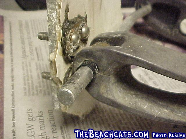

I did this upgrade on my first H18 (1981 model) after breaking several castings and then finally tearing out the stern when the rudders refused to kick up even with me yanking like H on them as I landed through the surf at Panama City Beach.
The upgrade is expensive, but not as expensive as repairing damage like this.

If the system seems to work fine then go for it, even damage like my picture can (and was) fixed, it's only fiberglass!
