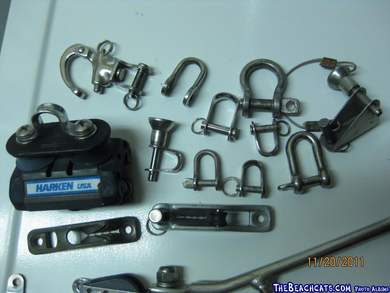

    NOTE: I'm using a larger car(4 1/2") than what I think you have, so the bearing count is different. I think this one in my spare parts bin is the one you usehttp://www.thebeachcats.com/gallery2/main.php?g2_view=core.DownloadItem&g2_itemId=83075&g2_serialNumber=3
