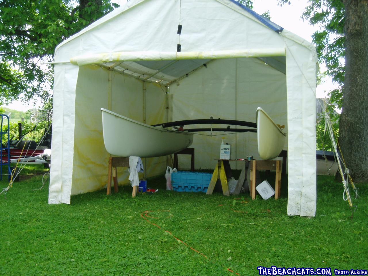

  • ~~ I tried the 'roll & tip' method. I thought it sucked. Rag full of acetone and took it all off (1/2 of hull), re-prep it then SPRAYED it... Some people have their favorite ways... I liked spray much better. I did 4 boats, I think I have 2 in the tech gallery, I'll see if I can find them.... BRB
    Painting the Hobie 18
    http://www.thebeachcats.c…ictures/?g2_itemId=62395
    http://www.thebeachcats.com/gallery2/main.php?g2_view=core.DownloadItem&g2_itemId=62412&g2_serialNumber=3
    http://www.thebeachcats.com/gallery2/main.php?g2_view=core.DownloadItem&g2_itemId=62404&g2_serialNumber=3
    http://www.thebeachcats.com/gallery2/main.php?g2_view=core.DownloadItem&g2_itemId=62429&g2_serialNumber=3
    Prep is the key thing when ya re-do a boat weather ya gel it or paint it.... it might look or feel good untill the coats go on, then ya use harsh words....... if ya think ya have a bad spot, get it before ya paint or gel. I used 60 grit on a vibrator sander then by hand where I couldn't get to it..... Yes 60 grit, the paint has to have something to hold on to, It'll fill in, besides I gave mine 3-4 coats..... Good luck & drink beer,,, (I drink strong dark beer) prost

    ~~ When I checked on it one little tiny pict showed up ?? actually it should'av taken ya right to the pages... 2 separate pages.... one for the 18, the other for my girlfriends 14T (hanging with rope)... Oh well just go up their and snoop around it's not hard to find...
    ~~~~~ Kevin... I think I used 4, maybe 5 qts. I have my own sprayer & compr. It's nuttin fancy, just yer average sprayer !!
    Paint is holdin up good, some minor scratches, but anything is gonna scratch---paint or gel. The paint is 'Interlux polyurathane" " Are ya sure ya hold hands ?" I think I'am older than you and more experinced.. "Cme'r little boy want some gum, candy, paint, wanna play with my sprayer ?? icon_biggrin

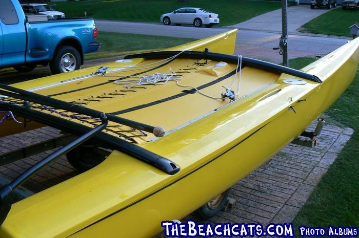

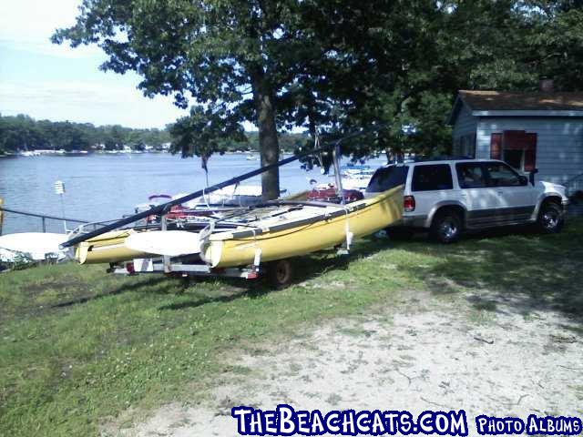

  • incase you were wondering how it went...
    before
    http://www.thebeachcats.com/gallery2/main.php?g2_view=core.DownloadItem&g2_itemId=81783&g2_
    after
    http://www.thebeachcats.com/gallery2/main.php?g2_view=core.DownloadItem&g2_itemId=81778&g2_serialNumber=4
    I used 2.67 quarts of the interlux brightside topside paint. 3 coats of rolling and tipping.
    SloSails did a great job too, Incase Andrew is out there.
    Nacra 6.0 NA
    Ogden Dunes, IN
  • After pic isnt working for me
    Greenville SC
  • That's weird, it works for me. Try this link:
    http://thebeachcats.com/pictures/?g2_itemId=81777
    Nacra 6.0 NA
    Ogden Dunes, IN
  • Looks great! Did you have to do any buffing or polish to get brush marks out, or did it just flow out that well? Very nice result regardless! clap
