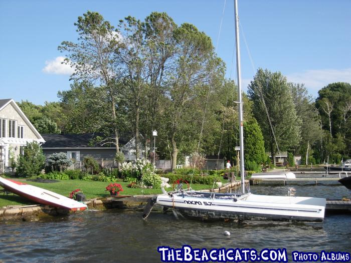

I'm in the same situation. Can you contact me via PM, & send a couple of photos of how you did your lift? You might have some better ideas than what I'm using.
I store my 5.7 on a modified seadoo lift, set beside the dock. I keep some large fenders against the dock, just in case the wind were to slide the Cat (even tied down) or tip the lift. I have six 30 lb weights hung on the frame. I tie them together with a short line, then hang them over the frame. It is way easier than moving the boat onshore, but it aint ideal. I might sell my power boat, & get a seadoo. Then
I could move the Cat onto the much larger vertical lift, where it would take a hurricane to tip it.
I've been out a couple times in just over 30 mph, as measured by the buoy about 1 mile away. There is so much spray that it gets hard to see. At my place if the wind is an offshore breeze, and you stay within 1/2 mile of shore, the seas are relatively flat. When we get a south wind of that magnitude, conditions turn to short steep wave sets that just pound the crap out of things. The fun factor goes way down, as I'm just trying to stay upright.

edchris, I use a full-size cantilever lift that came with the cat. It has a couple side rails to keep it from sliding off, and i was thinking of making some anchors by filling 5 gallon pails with concrete and an eye bolt. I'll try to get some photos to you. Where do you live anyways? sounds like you have similar conditions as us. We're on Lake St Francis, a wide part of the St Lawrence river in Ontario, Canada.

I keep mine on Lake Simcoe, water is 26C today!
The problem with the seadoo lift is it is narrow. I used the beams from the trailer, with an 8' deck board bolted to them to protect the hulls. The bows also hang way over the front, creating a large lever. I can't walk out on the bows to tension my portuguese turnbuckle, or the entire assembly will tip, even with almost 200lb on the rear beam.

Wow, Ed, sounds like an invitation for a disaster! I don't know how windy it gets on Simcoe, but if you get a blast like we did the other day your cat's gone for sure. If i were you i'd look around for a bigger lift - I occasionally see used ones going for around $500-$700 around here. New is over $2000. Not cheap but neither is a new cat!

I have too many large lifts as it is! The seadoo lift isn't as bad as it sounds, sideloads are pretty stable, as the cat only site appx 2' either side of the base. It is mostly the long bows hanging out front that create a long lever if you were to walk on them.
It isn't as good as a full size powerboat lift, & I have to be careful to position it just right. We get some pretty good wind, however the bay I'm on is sheltered from the big blows. A direct hit from a big CB would be a different matter, I using the Florida theory that hurricanes can only devastate a certain number of boats per year, & the next 2 are not mine
