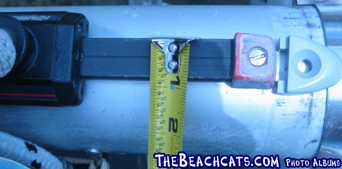

  • Here is my setup as it came with the boat. The extra endstops are
    Schaefer tapered end stop, as seen on the west Marine page.
    http://www.westmarine.com…arch?Ns=Most%20Popular|0
    If I filed off the nubs, the hole will line up with my old one. You can see the Schaefer stop is a lower profile, it wouldn't stop the traveler, unless it were shimmed up about 1/4".
    http://www.thebeachcats.com/gallery2/main.php?g2_view=core.DownloadItem&g2_itemId=80904&g2_serialNumber=4
    My track is 25/32" wide, & 17/32" high, with one groove for the car. I believe it is Harken, & the measurements are metric. I don't have a tape with metric markings at the lakehouse, but IIRC when I could still access the proper page on Harkens site it matched exactly with a small boat track that was given in metric measurements.
    At least it is a relatively easy, & inexpensive fix. If you would like a piece of 3/4" thick white delrin, from which to fashion a stop let me know, I'll mail it you.
    If you get your B in law to send a puck, con him into cutting it into slices (jigsaw, table saw, whatever he has)in the thickness/width you require. One slice will make 4 end stops,& you will be able to cut it with a razor knife, a whole puck is tough to cut without power saw. As long as the package is just under 1" he can mail it very cheaply.
