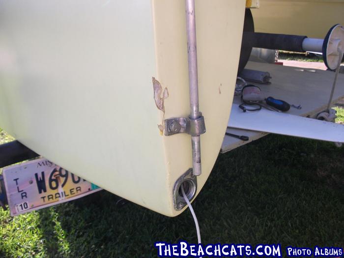

  • QuoteDo I have to cut a hole and glass it from the inside?
    in those structural/non foam core areas, you can sand past the gelcoat and build up ~4 or so layers of matt glass over cracks. i just added an album in the beachcats technical albums titled prindle 16 transom repair showing my recent transom repair. don't sweat the cosmetic stuff this season, you may not be finished repairing hull yet...get it sailing and see whats up!
    http://www.thebeachcats.com/gallery2/main.php?g2_view=core.DownloadItem&g2_itemId=79950&g2_
    http://www.thebeachcats.c…ictures/?g2_itemId=79947
  • coastrat i just added an album in the beachcats technical albums titled prindle 16 transom repair showing my recent transom repair.
    Good job with both the repair and the documenting pictures, thanks for taking the pictures. It helps the next guy take on the project knowing that a hole like that can be fixed.
  • thanks damon, still amazed at how many repairs i have made with one qt of west system...got my moneys worth for sure. really don't miss film cameras, digital is so nice, just buy batteries!
    anrkii, meant to tell you this crack/tear needed to be cut out(loose material) first i had to pull a few tricks working around the plywood and aluminum on the transom. stress cracks can be glassed over and injected if need be. i love working with glass, if you don't like what you did, cut it out and do it again!
