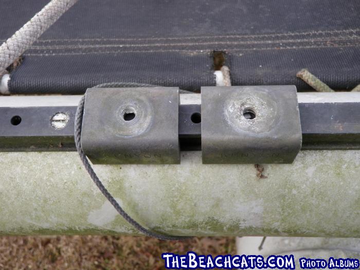

I just bough a 1977 Nacra 5.2 the mainsheet traveler car is an old non harken car that is in a zip lock bag in pieces looks like the same car that is on the outhaul on the boom anyone know who made this car? Can I rebuild it or do they sell them anymore or have a newer one to replace it?

I have an extra one of you can't rebuild that one. I'd be on the lookout for a harken car/track replacement, though.

the original fitment on the older boats was schaefer i think
my 1982 jib halyard has a schaefer shackle on it
these people might be of help
http://schaeferhardware.com/SearchResult.aspx?CategoryID=381
if not the harken car would probably be a good upgrade
if you are looking for track try to get as long as possible, later nacras had tracks that went over the beam straps and right to the end. for better downwind performance? -

the later Nacras had extruded aluminum tracks, which is why they went to the ends. Lighter, cheaper, simpler, etc. The beam straps went through a narrow slot machined into the extrusion.

Some early 80's had the extruded Harken track but it only went between the straps.

Track question for you all. My old boat is a 1986; however, the prior owner had the mast ride on the track at some point, so there is a chunk taken out of the front of the track, say 5/16". I have been searching for track inserts. Is there a way to replace but a short section of track?

I have a Nacra traveler car on a short piece of track. Pete 909-800-5237 -
