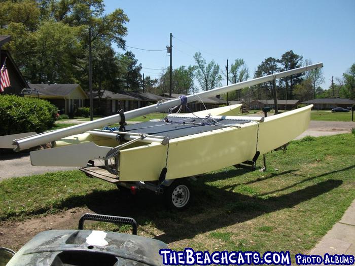

since you are mainly trailoring local to launch site, i would keep rudders on but if its a long haul take them off. here is a pic of my mast bracket, its fast and easy to use.go to members albums and click on "prindle 16 hull repair and paint" find this pic and click on it a second time for a closer look(larger image). note 1/2" line tied around rudders and castings to keep rudders up during trailoring.

I looked at the larger picture but cant tell what it is? Did you make it or buy it? Thanks -

store bought, previous owner...can't help you there, but sure there out there...makes trailoring that much faster.
