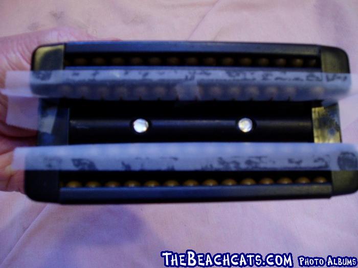

    What if I took 2 strips of regular Scotch tape, wiped the adhesive off the center strip with a Q-tip & alcohol, stuck the tape to the sheet a couple of times to almost eliminate the adhesive remaining on the edges, then used it as a retainer. By having the tape long enough to protrude from the ends of the car, I figured I could grab it with needle nose pliers & pull it out after the car was on the track, as they don't mate up to microscopic tolerances.
    The idea worked so well that it went together in less than 10 minutes. 32 balls to a side, install tape strips, turn beam upside down & gently slide car on, holding it in the position shown. Once on I turned the beam 90* & used a razor knife to gently prise the weakened tape loose from the outer edge of the car, leaving it attached only by a thin strip on the inside of the car. It was then very easy to pull the tape out from the end of the car.

    http://www.thebeachcats.com/gallery2/main.php?g2_view=core.DownloadItem&g2_itemId=71931
