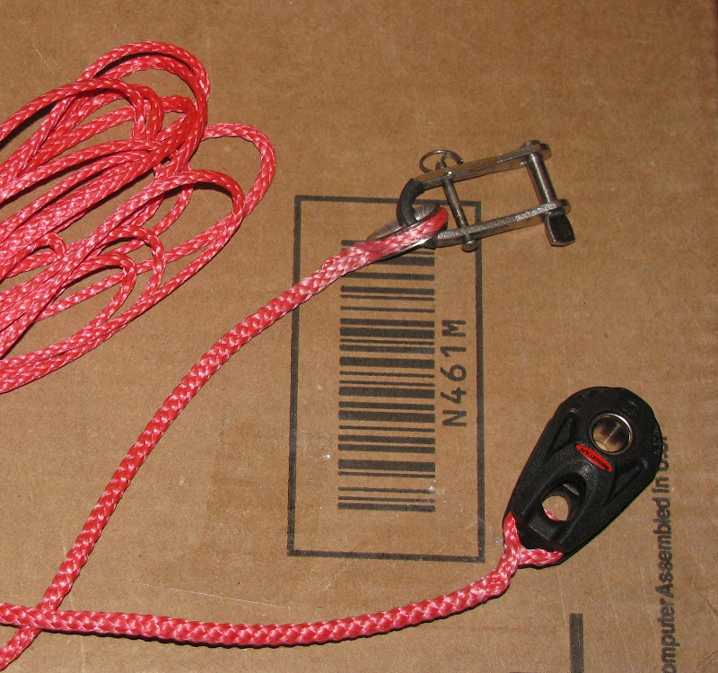

  • Decided to make a new jib halyard. Old one frayed, have line and block and shackle, etc...went for it.
    Here's how it turned out
    http://lh5.ggpht.com/_PPRkiYPDA_Q/S0lg9sCdE0I/AAAAAAAADCg/VqkbILUKn9w/s800/New%205.2%20Jib%20Halyard%20010.JPG
    Old one weighs 6.6oz, new one 2.7oz. The quarter pound will never amount to anything but 60% weight savings isn't bad at all. (actually the halyard shackle on the new one is the heaviest single part there; I bet its 2 of the 2.7 oz)
    I spent the better part of 3 hours trying to bury the tail in the first brummel I made, and finally gave up and went to bed. The 2.75mm dyneema is just too small for any of the fids I have. It almost seemed like I could make it work with a large needle that I use to whip. This morning I remembered a post by mummp in which he said he just used some knitting needles. Looked up the post to make sure I wasn't crazy, then drove to Michael's and bought 8 different needles, 4 actually crochet needles, 4 knitting for around $12. I tried once with the line from last night, and realized it was hosed at this point so I started over.
    With the crochet needles I knocked the whole thing out in no time...maybe an hour start to finish. Its almost amazing how easy it was.
    Anyway, thanks mummp for the tip on the needles, and everyone else on all tips from the discussions of HM line lately.
    Rob
    OKC

  • Here are the two splices up close.
    http://lh5.ggpht.com/_PPRkiYPDA_Q/S0lo18ZwVdI/AAAAAAAADDA/mB4jQRKncgw/s800/New%205.2%20Jib%20Halyard%20008.JPG
    Rob

  • whats the black on the like with the block? dipping whip?
  • No, nothing that fancy, just heat-shrink. I wanted something to protect the eye from chafing on the block.
    The edge of the heatshrink may chafe the line given enough time, or may just get torn up against the metal, but either way it took 1 minute to do and is certainly easy to inspect.

  • Couldn't resist:
    http://lh3.ggpht.com/_PPRkiYPDA_Q/S2Xz4FFFl6I/AAAAAAAADQg/HP-Tq8QRzz8/s800/n5.2Halyard%20001.JPG
    I suppose this way if it frays I'll have an extra. I like this block better (30mm - same size), and with the thimble there's no worry of fraying on the shackle.
    The shackle had some knicks in it which I lightly filed down, then covered w/ heat shrink to be sure....and then I remembered I had the thimble in the bottom of a toolbox somewhere, hence the total overkill.
