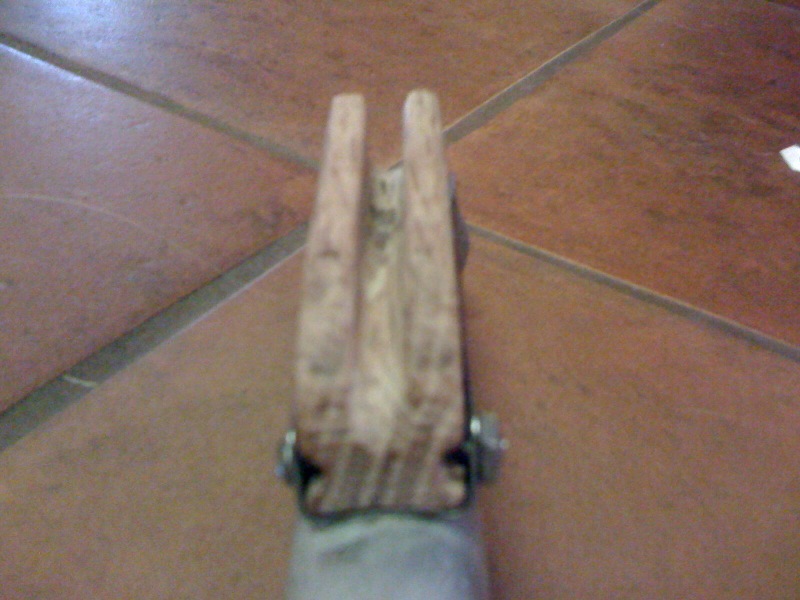

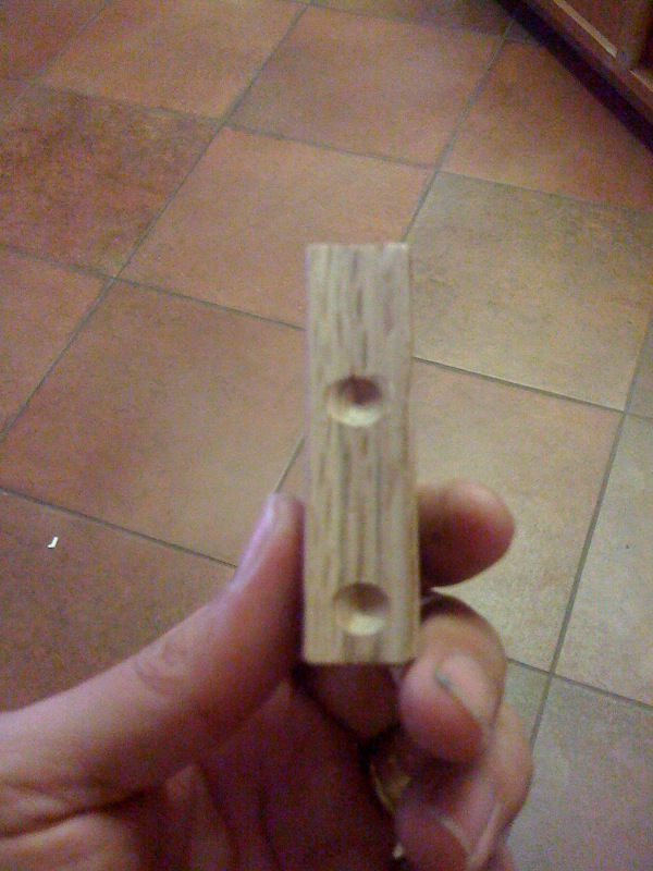

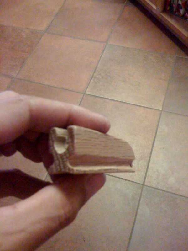

    That "other" piece that keeps the rudder line in place, I don't know what it's called. I can tell you that both of mine broke. The original owner replaced one of them with an oak copy. The other one broke on my first trip and I had to make another one out of oak myself (I had some ironwood and teak on-hand, but made it out of white oak just to match the other one).
    It took about 30 minutes with a small saw and a file to fabricate and it works well.
    I'll post a pic for you and you can see how easy it is to just make one up.
    Dan

    Now that's the cat's meow. Very hot looking compared to my primitive fix.
    Thanks Steve.
    Dan
