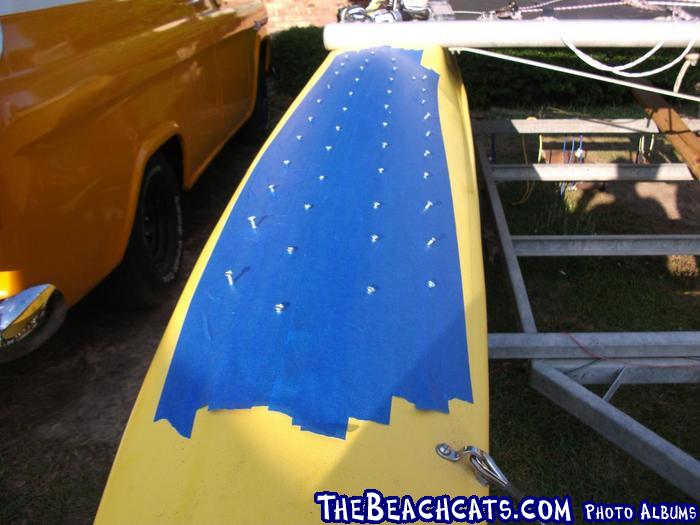

Im almost done with the delam repair, the worst of it was the outside of the right hull. it sat in direct sunlight for a decade..
its a "soft spot" that ten feet long and the width of the hull. 255 holes! Turned out rock solid, though
http://img822.imageshack.us/img822/2690/1001950h.jpg
Ill have about 3 1/2 gallons in it total, But i estimate about 650-700 holes in the thing.

I Did all three sides of the hulls, decks included, on my spare time. I would say maybe eight hours total on the injection.
I didnt spring for epoxy for my repair, since i ended up using 3 1/2 gallons. standard bondo fiberglass resin by the gallon, $30 a can at the local auto parts store. It wasnt all that bad, Ive done far worse jobs with fiberglass before.

did this beauty friday night...frankenstein!!!....worked great! took her out sunday afternoon in a nice blow on maiden voyage. injection will get you sailing fast!
