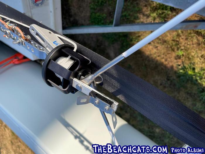

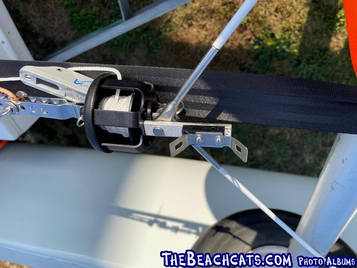

NACRA 5.8 Telo-Cat Bridle Vane Bracket for new Harken roller
Upgraded my jib to roller furling (finally...The Murray's kit is solid BTW) and adapting my wind indicator required some adaptation, as the older furlers allowed a bracket on top. So, I fabricated a bracket from 1/4" aluminum and made sure the top rested on the stationary furler cage. Thought I would share in case anyone else wanted to adapt.
https://www.thebeachcats.com/gallery2/main.php?g2_view=core.DownloadItem&g2_itemId=135426&g2_serialNumber=4
https://www.thebeachcats.com/gallery2/main.php?g2_view=core.DownloadItem&g2_itemId=135429&g2_serialNumber=4
