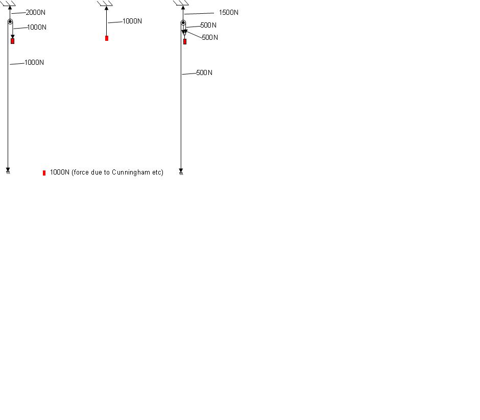

I don't think changing the way the halyard is rigged will have an effect on mast load. The downhaul is pulling with a given force. Shouldn't matter if it is pulling against the hook or a 10:1 setup, unless you also crank down on the halyard.
i remember we discussed it a while ago. If you assume that friction is not significant, then the halyard tension would be the same as the downhaul tension, either one that you crank would have the same effect. So both equal forces pointing down would be the double compared to the downhaul forcé pulling against the hook. In practice there is friction, so the effect is something in between at the top of the mast.
QuoteI don't think changing the way the halyard is rigged will have an effect on mast load. The downhaul is pulling with a given force. Shouldn't matter if it is pulling against the hook or a 10:1 setup, unless you also crank down on the halyard.
Bingo - by removing it from the hook you are also cranking down on the halyard (now unlocked)
thus the x amount of force your cunningham/downhaul are pulling is x times 2 (up the halyard and back down)
"Visualize a halyard lock at the top of the mast. With halyard locked it's 1:1 compression on mast to down force on halyard from Main.
Now with a 1:1 halyard, the halyard sheeve is a block and this creates a 2:1 purchase, so you actually have twice the compression force on the stick as halyard tension. "

furthermore, adding a second block into the mix (say at the top of the mast like my 6.0 has) makes this 2x down to 1.5x
http://www.yachtsandyachting.com/photos/forum/Peaky/2009-03-18_123015_mast_compression.JPG
Ignoring friction losses... Mast compression is least with a halyard lock (1000N in this example), most with a 1:1 halyard (2000N) and 1500N with a 2:1 halyard.
It's been a long time since my school days but I'm fairly certain that in a static load the sum of the external forces must be 0. So if the downhaul is pulling 60lbs the mast is resisting with equal force regardless of how the sail is rigged. Any mechanical advantage in the halyard should reduce the tension where the halyard is tied off.
I agree that more advantage on the halyard could increase the load on the mast a bit if the halyard stretches but it can't exceed the force applied by the downhaul.
Forgot to mention a single block simply redirects the pull. Don't think it affects purchase.
Right, no purchase if you compare the halyard side vs the downhaul side, the force is the same at both sides of the pulley. The double force is the resistance of the mast to hold the pulley, standing those two forces. Take the pulley as the system and those 3 are the external forces.
Now what is arguable is whether you really need to apply the same downhaul force in both cases. On strong wind it's about bending the mast, not about stretching the sail or removing the wrinkles, which already happened under the forces applied. If the halyard is coming down through the mast track, then I think it's also helping to bend the mast in the same way as the downhaul, so probably you would need half the force on the downhaul (+ half the force on the halyard) for the same effect on the mast, compared to hooking the main at the top.
From an earlier discussion
https://www.catsailor.com/bb_files/11514.gif
QuoteI disagree with those calculations... The sail gets a tension of T on all three cases. The 2T and 1.5T apply not to the sail but perhaps to the mast head, wich is of little interest. The most relevant is that you need half the tension on the halyard (and double the lenght and time to raise) in picture 2. Also interesting is that in picture 2 the mast head pulley gets half of the load compared to picture one. If you want to apply constant tension with the full halyard that is relevant too.
Picture 1 compared to picture 3 is interesting if the halyard goes down through the mast track. Imagine that it's a dyneema halyard attached at the base of the mast instead of a hook at the top, and you have a 10:1 (or less perhaps) downhaul. Then you double the effect of the dowhaul: 1T on the sail and 1T on the halyard, except that now T may be amplified with the downhaul. With other kind of line all this theory is defeated with the stretching of the line, of course. Which I bet it's the original reason why there is a hook, even on old boats without a powerful downhaul. But as said, it may sound good but you don't want to apply all that tension on the mast head pulley, you will likely break something there.
On the other hand, if the halyard goes down at the front of the mast, as hannes-neo explains, the effect of the downhaul is canceleed by the tension of the halyard in front of the mast. Unless the fork is installed near the mast head, in front of the mast, as it is meant to.
Edit: hope you didn't read in between my edits...
yes the forces on the sail / luff are the same, but on the mast (head) they are increased
QuoteNow what is arguable is whether you really need to apply the same downhaul force in both cases. On strong wind it's about bending the mast, not about stretching the sail or removing the wrinkles, which already happened under the forces applied. If the halyard is coming down through the mast track, then I think it's also helping to bend the mast in the same way as the downhaul, so probably you would need half the force on the downhaul (+ half the force on the halyard) for the same effect on the mast, compared to hooking the main at the top.
YES!
so 1/2 the downhaul = 100% downhaul with the sail on the hook
what happens when crew doesn't know this and applies 100% downhaul
YES!
If there are marks they would be off, but it's another sail, the crew should not be expecting the same adjustments. And in my book its the captain's responsibility anyway...
But the risk could be mitigated by threading the downhaul with less purchase.
agreed - many ways to handle the double compression on the mast
but at least we seem to agree now that there is more load on the mast by taking the ring off the hook

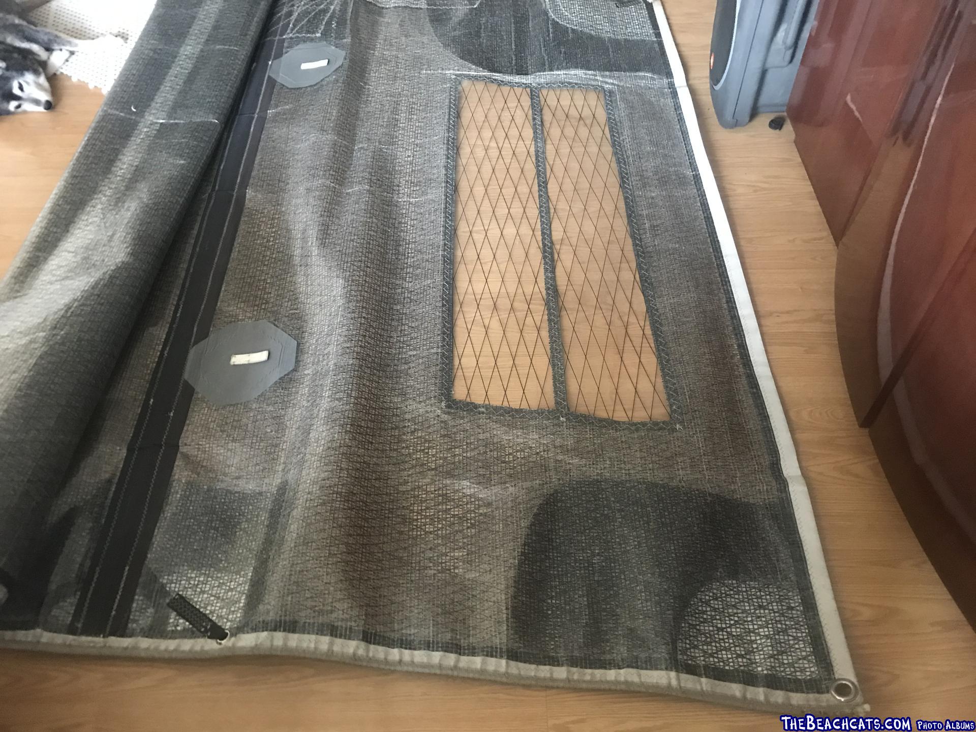

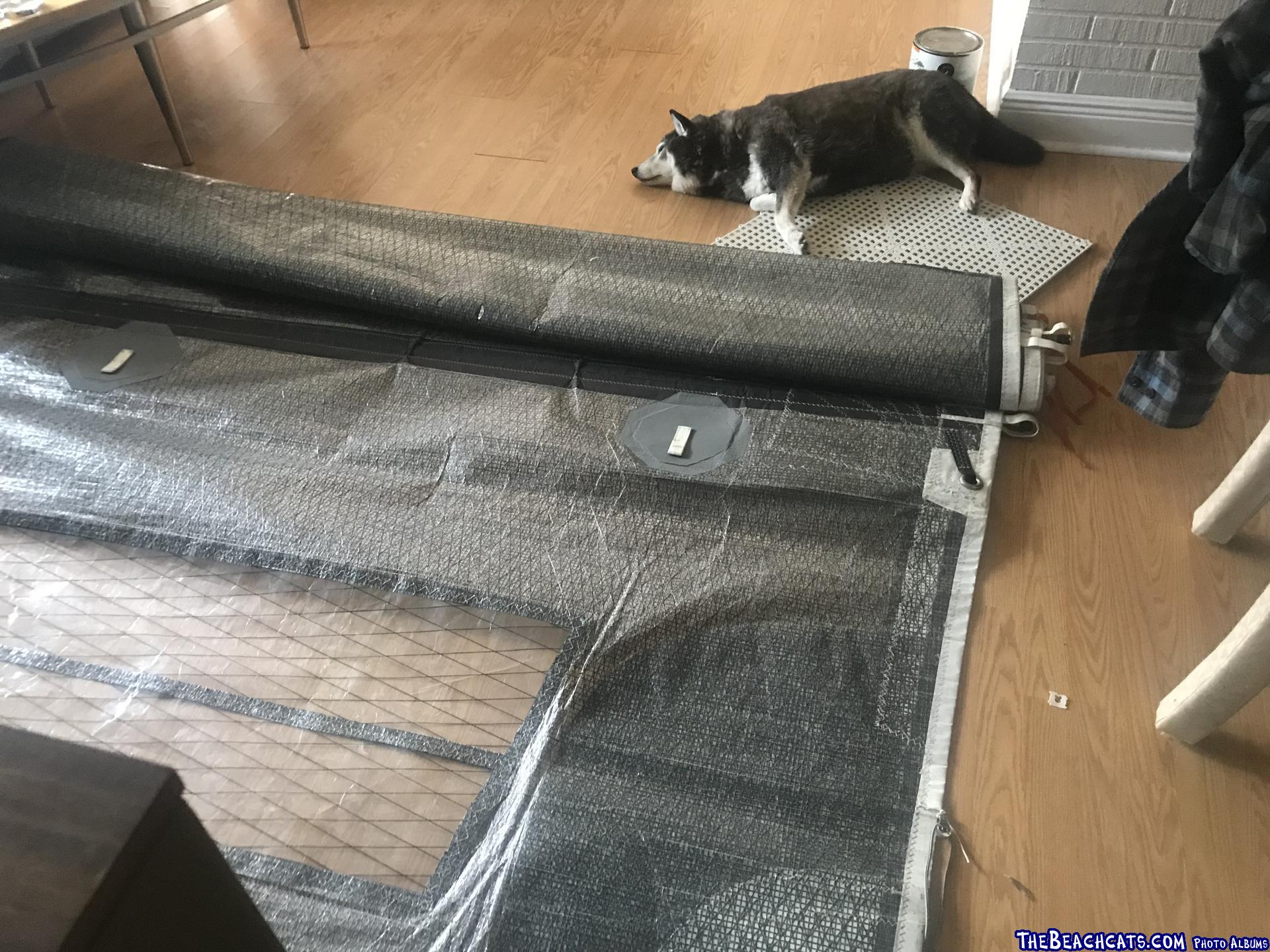

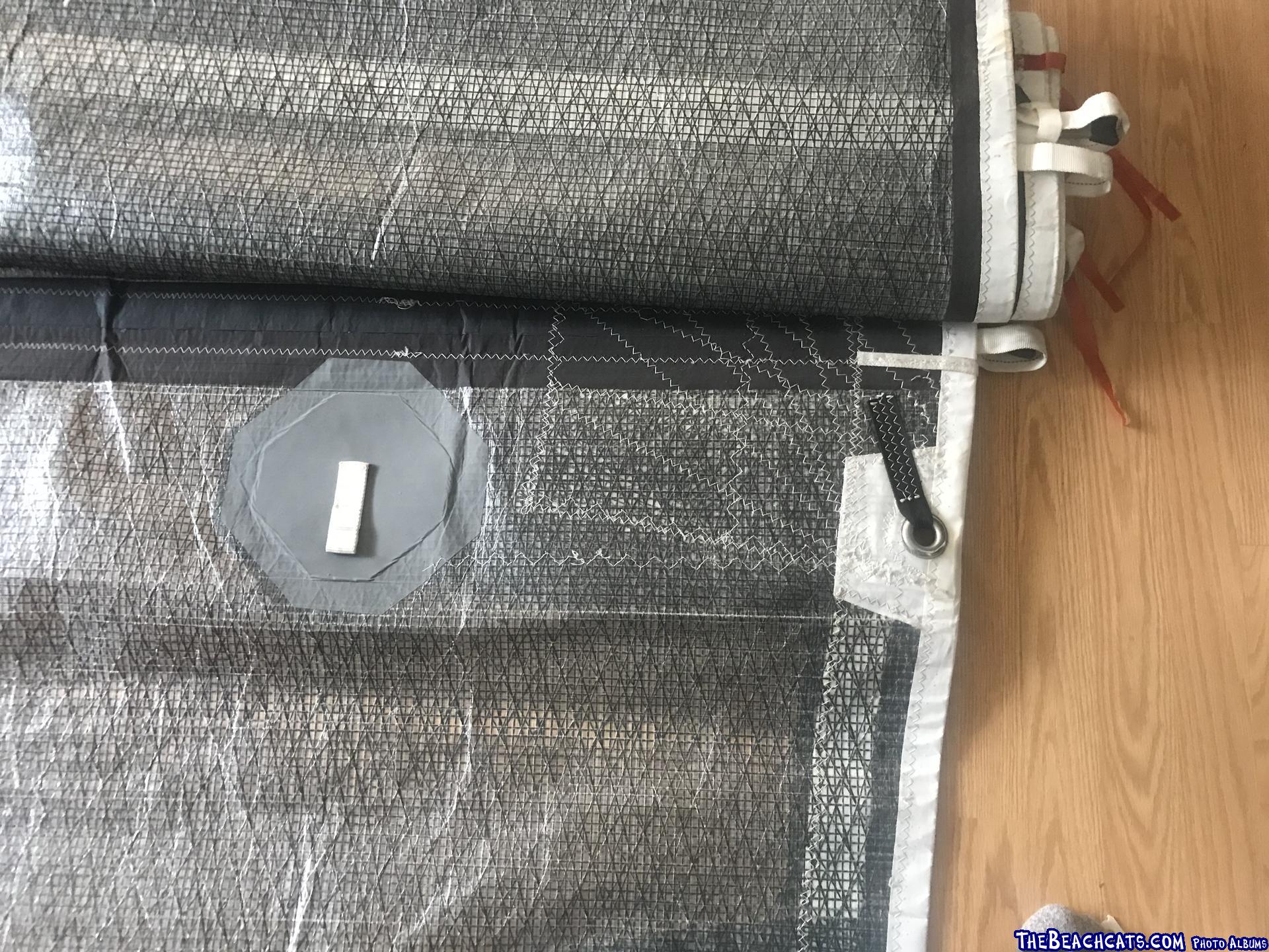

I'd like to add some reefing points to my sail while it is here in the basement.

The lower (unused) portion of the sail gets wrapped up and tied as you described. The clew and tack fittings at the reef points definitely need to be reinforced to support the downhaul and mainsheet loads. The reef points in the body of the sail don’t need as much reinforcement since they are just holding the sail roll and not intended to support any load from the sail controls.

QuoteWhat do you do with the bolt rope that doesn't get fed up the mast?
bolt rope is your luff - it is connected to your main - on my setup you roll up the bottom of the sail and use the reef points to secure it
Quotedoes the forward reef point need a good connection to the downhaul attach point?
the reef points are not for your downhaul - you need a new downhaul grommet or strope (that is reinforced) to be the new downhaul attachment and one for the clew
QuoteIs it ok just to wrap the reefing line around the boom batten?
my setup has 2 patches on the sail. on the patches are very small loops/stropes.
when i lower the sail to "reefed", attach the downhaul to the new location (tack/grommet) and attach the mainblocks to the new location (clew/grommet) i then roll up the 5' (est) of sail. i tie a micro line from one side of my sail, around the sail roll and tie to the other patch/strope. (2mm dynema? but could be any small line - there is NO force applied to this line, it is simply holding the bottom of my sail that is now rolled up)
QuoteAs you go from the luff to the leech how many grommets should there be? Obviously has to be at least two but seems like you would need more to hold the bottom of the reef to the bottom of the sail. How big do those lines need to be?
tack / reef point - reef point / downhaul
dental floss would work - your just holding the bottom of a rolled up sail
