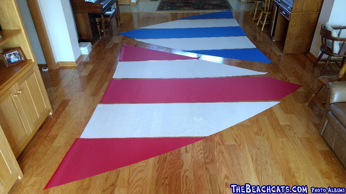

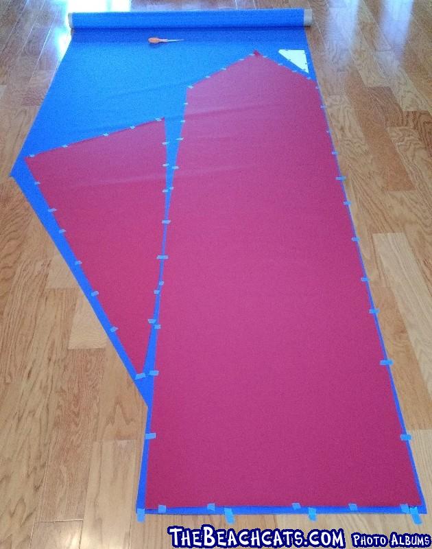

I am making a couple of practice sails for my little boats. They are 55 ft^2 lateen sails. I'm using 4oz dacron just to work with the same material that I plan to make my SC17 sail out of. I used Sailcut CAD and plotted the panels out by hand.
https://www.thebeachcats.com/gallery2/main.php?g2_view=core.DownloadItem&g2_itemId=134613&g2_serialNumber=3
Because I am making two identical sails, I plotted one and traced one. Plotting by hand sucks! My kid and I will work on a plotter/cutter this summer.
https://www.thebeachcats.com/gallery2/main.php?g2_view=core.DownloadItem&g2_itemId=134614&g2_serialNumber=3
Here are my two sail kits. There is some serious sewing in my future.
https://www.thebeachcats.com/gallery2/main.php?g2_view=core.DownloadItem&g2_itemId=134618&g2_serialNumber=3

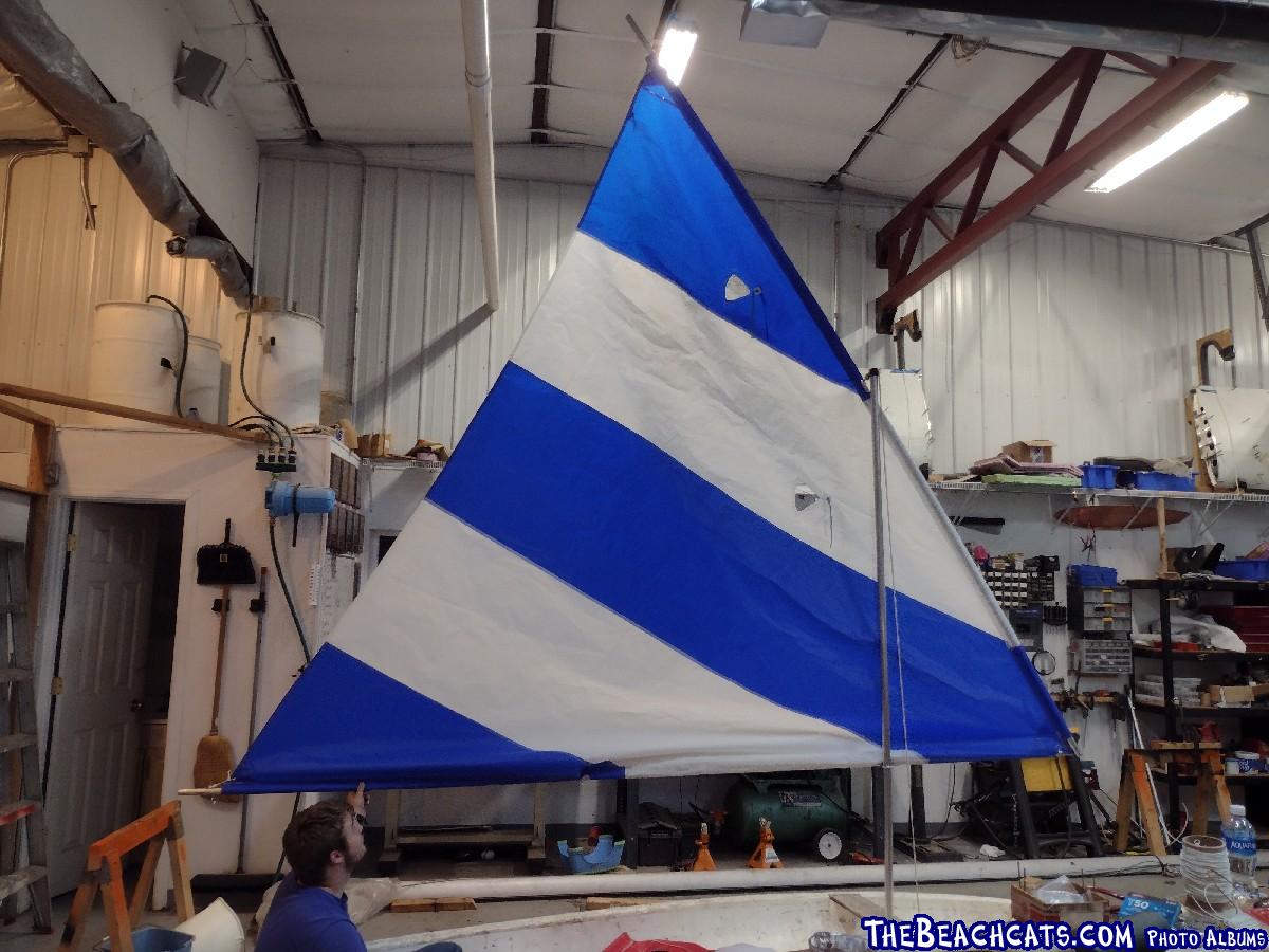

I've been working on this sporadically. The sails have come out pretty good. Compared to the old ones they have a lot more shape - some of it due to Sailcut generated panel curves, and a lot from the foot rounding. We should have these on the water this weekend and see the results.
https://www.thebeachcats.com/gallery2/main.php?g2_view=core.DownloadItem&g2_itemId=134838&g2_serialNumber=3

We got the new sails out today. What a transformation - lots more power. Some of it is from going up to 55 ft2 from 45, but also these sails actually have shape. So I'm pleased with my efforts. However, we did have one little issue:
https://www.thebeachcats.com/gallery2/main.php?g2_view=core.DownloadItem&g2_itemId=134846&g2_serialNumber=3
I'm afraid we may have outgrown our foam boats. Time to get the H16 going.
Video to follow...
Bryan in Poplar Grove, IL
Hobie 16, 1978 - current boat
Congrats on your first sail. Any pics in action? Well if you're trying to go fast and breaking stuff, that's about right, so you MUST be on the right track!
Chuck C.
H21SE 408
Hey Chuck,
No pictures, because we often end up turtled so we leave the phones on shore. I was going to take a picture of both boats next to the water when we got back, if the wind had died down. But my kid recently got a gopro, so we have some video:
https://youtu.be/hcRpHW9wr8I
I was on the other foam boat and it has never gone so well. I had to sit on the gunwale to keep it upright & flat and it scooted a lot better. I know these are not beachcats, but they are still fun. I think the focus in terms of working on boats will be the Hobie 16.
