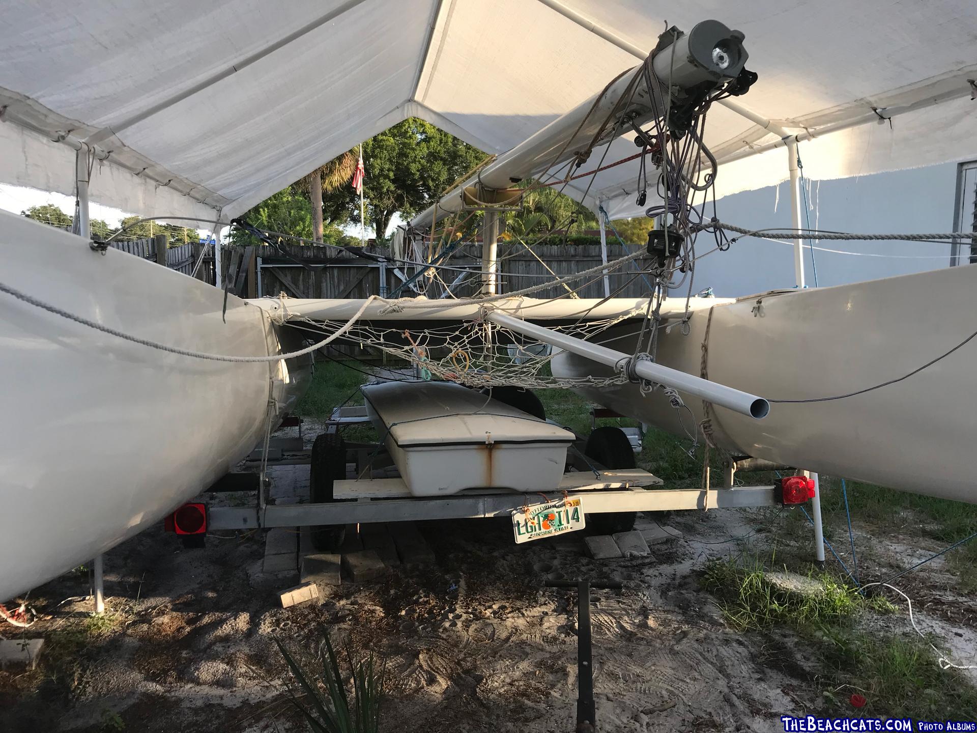

i currently have a CF windsurf mast rigged identical to a spin pole but cut shorter to hang a small front tramp off of and to secure a turning block under my furler for "on the fly jib luff control"
so i have some insight but not exactly what you requested.

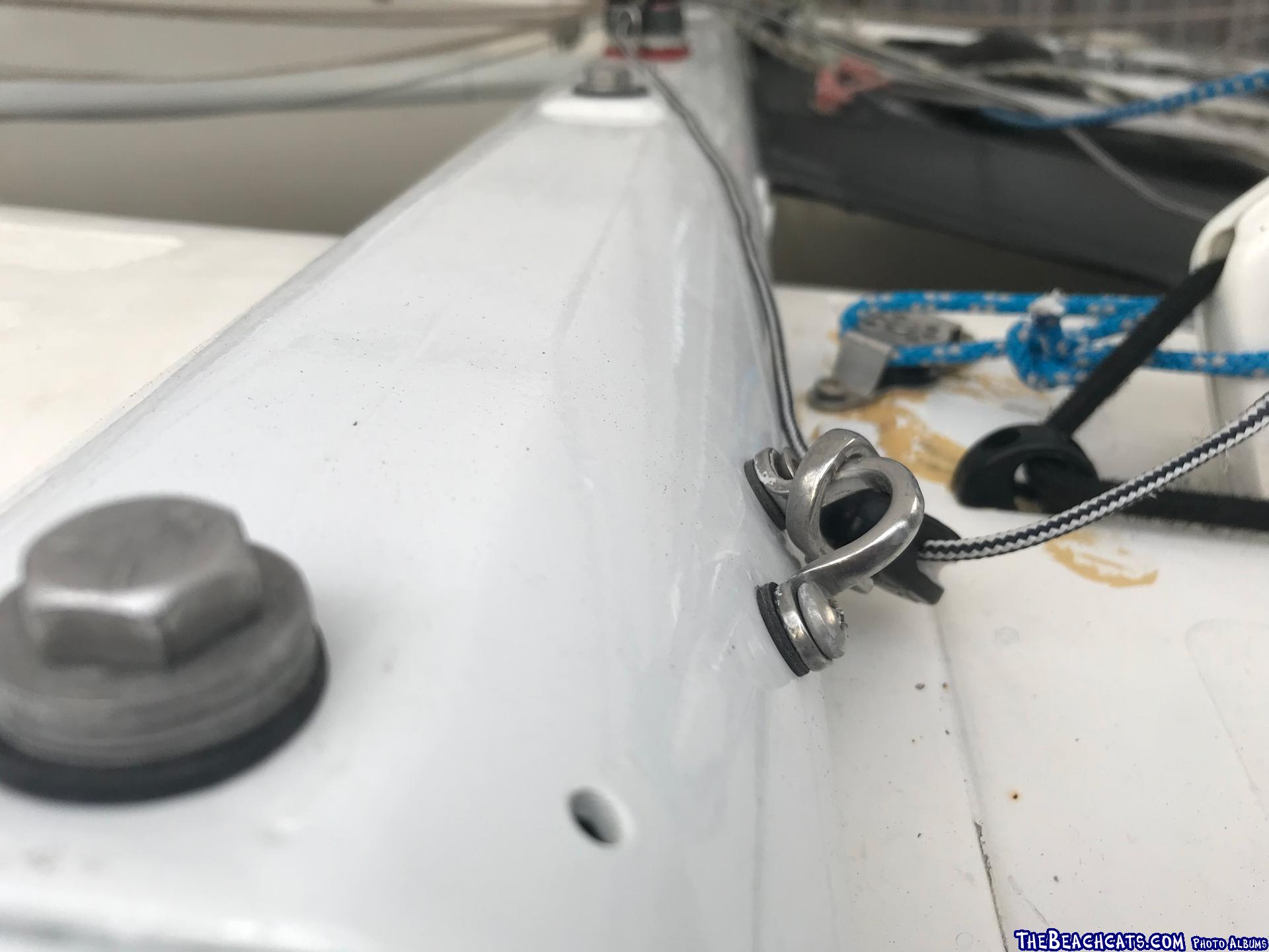

one more suggestion: CF and salt water don't mix. if you sail in salt... i highly recommend you get synthetic spacers/washers of some kind to seperate all metal (bolts/nuts). I also liberally applied tef-gel and still have rust
https://www.thebeachcats.com/gallery2/main.php?g2_view=core.DownloadItem&g2_itemId=131915&g2_serialNumber=3
spacer reference (also done inside the beam)
https://www.thebeachcats.com/gallery2/main.php?g2_view=core.DownloadItem&g2_itemId=131844&g2_serialNumber=3
