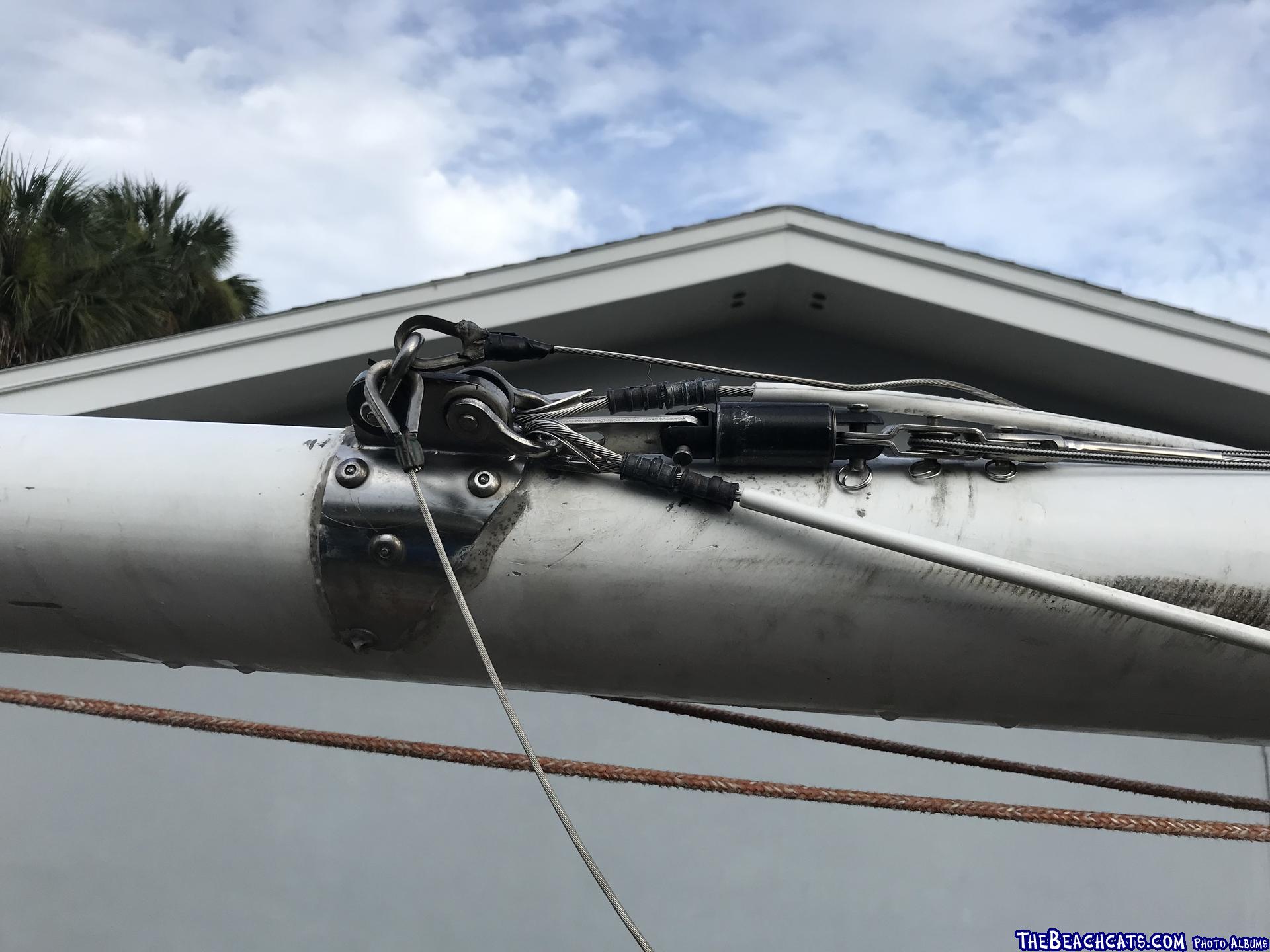

QuoteAndrew, appreciate the advice on the roller hardware. Will that low profile harken accomodate the swaged thimble found on our forestays, or are you expected to use a D shackle, etc?
my 5.5 has a Tipan jib halyard inline block assembly (i think that's where that came from)
My 6.0 has a long D shackle inline
PS - not suggesting anyone change out a working ronstan for a harken - just my personal preference
https://www.thebeachcats.com/gallery2/main.php?g2_view=core.DownloadItem&g2_itemId=131674&g2_serialNumber=3
https://www.thebeachcats.com/gallery2/main.php?g2_view=core.DownloadItem&g2_itemId=131675&g2_serialNumber=3

Good close up photos. Thanks. That inline block is slick.
There's a short chainplate above the 5.5 swivel. Anyone know if it's available separately? Or suggest a solid adjustable alternative? Like this:
https://pull01-apsltd.netdna-ssl.com/media/catalog/product/cache/1/thumbnail/9df78eab33525d08d6e5fb8d27136e95/r/f/rf27.jpg
I store mast up in lotsa wind, so I would feel better about adding a well-made 2-3" extension plate than a D shackle.

nohuhuGood close up photos. Thanks. That inline block is slick. .
That type of inline block is for use with wire halyards, if you are using line, you are wasting the $35 they cost.
I started out with that on the N5.7, but ended up using Spyderline for the halyard, along with a small Harken block.
You can see both setups here.
https://www.thebeachcats.…ictures?g2_itemId=88268]

QuoteThat type of inline block is for use with wire halyards, if you are using line, you are wasting the $35 they cost.
the block works fine with non wire too -
i am not a fan of wire halyards
they require crimping tools
they break, and strands can end up under your skin
i will probably never purchase another - hm line is easier, cheaper and available in many local locations
