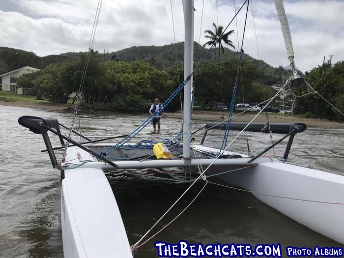

WE PUT GETAWAY WINGS ON A PRINDLE!

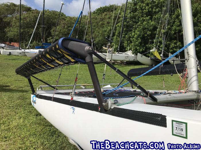

That's right. They can be added and it's not that hard to do.
https://www.thebeachcats.com/gallery2/main.php?g2_view=core.DownloadItem&g2_itemId=131220&g2_serialNumber=4
My friend and I have been hankering to add some Prindle factory wings to his already-great P18-2 for years, but have been frustrated with the lack of original parts out there. So when a Getaway was ready for the boneyard recently, we bought a salvaged set of wings and went to work. The results are great.
https://www.thebeachcats.com/gallery2/main.php?g2_view=core.DownloadItem&g2_itemId=131172&g2_serialNumber=4

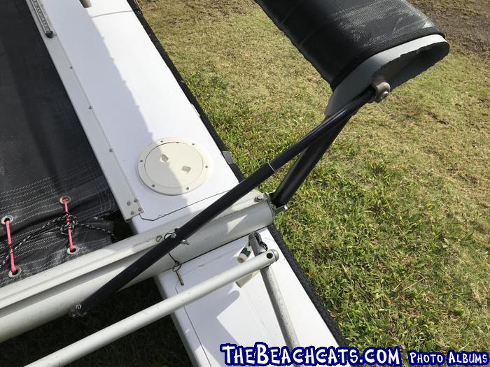

At first, we thought the Hobie benches would have to be lengthened or offset to fit the Prindle beams, a prospect with limited chance of success. But it turns out we needed to shorten them a few inches and we were able to retain the same mounting brackets and geometry used on the Getaway.
https://www.thebeachcats.com/gallery2/main.php?g2_view=core.DownloadItem&g2_itemId=131181&g2_serialNumber=4
This means the wings still fold for storage and transport, and are easy to remove, should we want to do that for racing.
https://www.thebeachcats.com/gallery2/main.php?g2_view=core.DownloadItem&g2_itemId=131188&g2_serialNumber=4

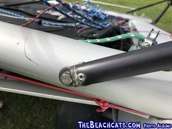

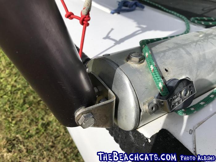

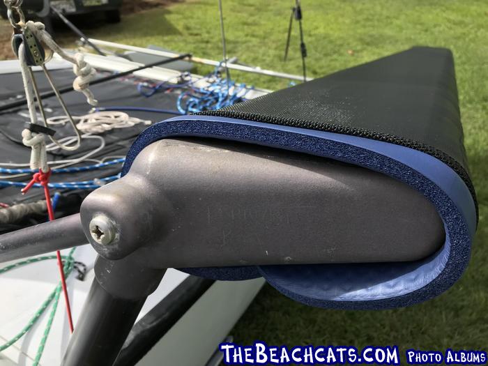

We had to purchase endcaps for the Prindle beams, and designed internal brackets that secure the external Hobie brackets to the internal beam/hull connections. Sorry there are no picts of this, but think a thick aluminum channel that is strapped around the vertical hull bolts via 2 long stainless bolts. The rest of the wing hardware is stock.
https://www.thebeachcats.com/gallery2/main.php?g2_view=core.DownloadItem&g2_itemId=131192&g2_serialNumber=4
With the exception of a different length bolt to replace the soc head that attaches the extension arm to the beam.
https://www.thebeachcats.com/gallery2/main.php?g2_view=core.DownloadItem&g2_itemId=131208&g2_serialNumber=4
You can set the rake angle of the seat by deciding where these holes are drilled. Looking around we measured between -5º and -14º on several other Getaways and decided -6º felt about right for us. You could always drill another hole for the pin in the extension arm if you want to have a different seating angle, such as positioning the benches further away from the hulls (for added hiking effect).
https://www.thebeachcats.com/gallery2/main.php?g2_view=core.DownloadItem&g2_itemId=131212&g2_serialNumber=4
My favorite mod was experimenting with different types of closed cell foam under the new mesh seat covers, My boney arse approves of this one!
https://www.thebeachcats.com/gallery2/main.php?g2_view=core.DownloadItem&g2_itemId=131200&g2_serialNumber=4
Now it's time to sail and enjoy,..

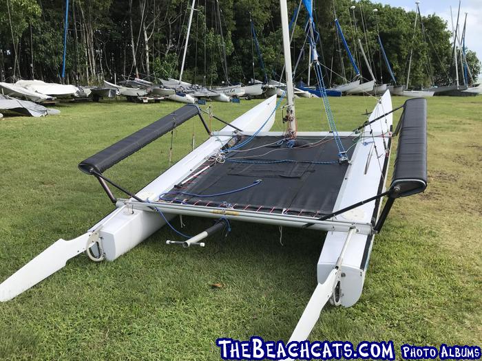

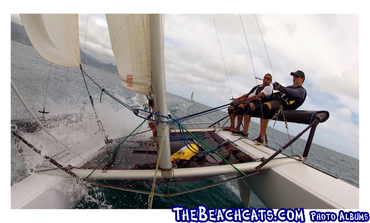

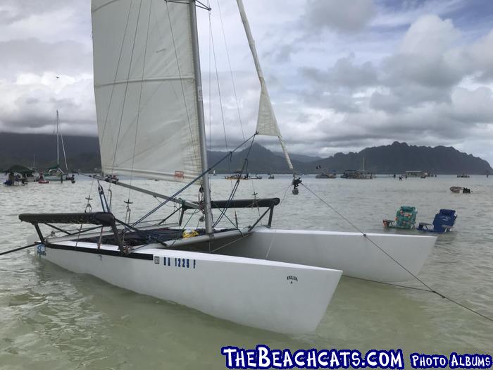

BEFORE:
https://www.thebeachcats.com/gallery2/main.php?g2_view=core.DownloadItem&g2_itemId=131266&g2_serialNumber=4
AFTER: icon_cool
https://www.thebeachcats.com/gallery2/main.php?g2_view=core.DownloadItem&g2_itemId=131247&g2_serialNumber=4

Nice setup with the wings....they look very comfortable.
Bill 404 21SE
Great job guys, I always thought the getaway wings could be adapted with minimal effort to work with most beach cats.
Thanks for the share. Looks pretty straightforward and doable. Anyone know of wings in VA?

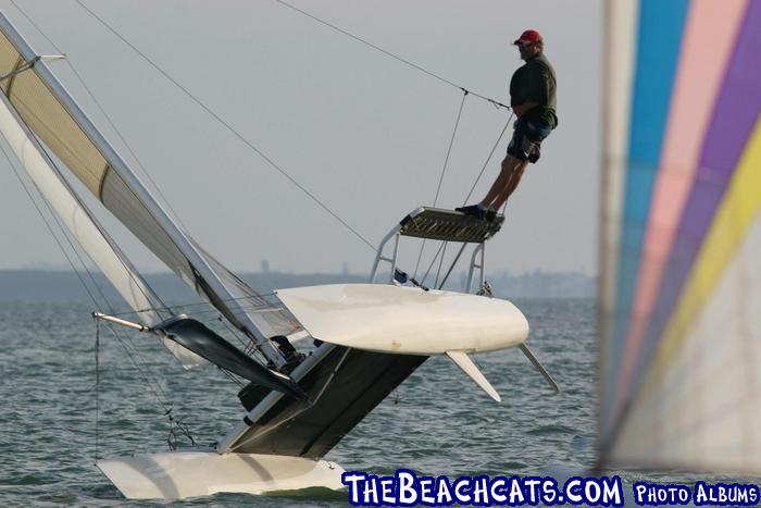

now trap out on those ...
https://www.thebeachcats.com/gallery2/main.php?g2_view=core.DownloadItem&g2_itemId=131390&g2_serialNumber=4
https://www.thebeachcats.com/gallery2/main.php?g2_view=core.DownloadItem&g2_itemId=131396&g2_serialNumber=3

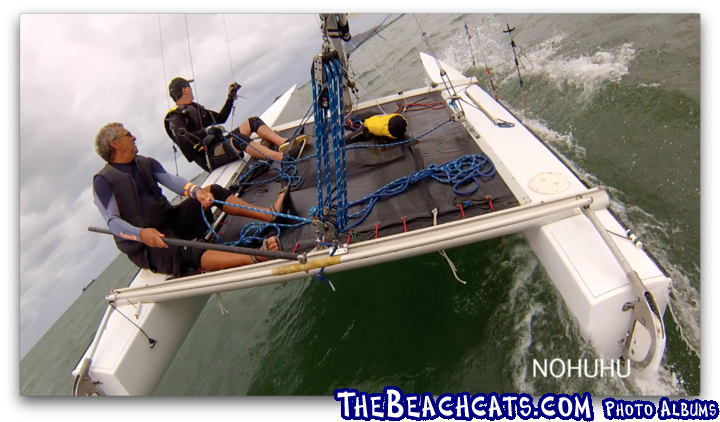

That's on the agenda for tomorrow! Which brings up a good subject.
Sitting on the wings is NOT the same as old-fashioned trapping when the boat starts to heel. Two-up on the bench seems to have about the same effect as having a large crew member on the wire - until it gusts. You don't have the same ~20x mechanical advantage you get while pulling the top end of the mast. The original trap lines and handles are at the wrong height to use now.
During testing in 15-25 mph wind, I rigged a chicken line to the shrouds and leaned over the seats to add a little righting effort. Big difference. I expect 2 seated crew adding a little extra leverage to the mast should handle most any wind. (We usually don't double-trap anyway).
We guesstimated, and trimmed about 1 foot off the rear trap lines and reswaged them. The front set will require a little more. I'll know better after I get a chance to hike out this weekend.
Any advice on making these trap adjustments and useful wing hiking techniques would really be welcomed.

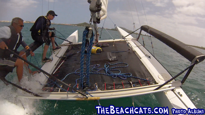

BEFORE,..
https://www.thebeachcats.com/gallery2/main.php?g2_view=core.DownloadItem&g2_itemId=131268&g2_serialNumber=4

QuoteAny advice on making these trap adjustments and useful wing hiking techniques would really be welcomed.
the wing fabricator added hiking straps to the wing frame - it allows all to hike out and i am told this is also very helpful after a capsize. (i have yet to capsize with my wings) but the fabricator/owner did 1 time with his wife and kid https://www.thebeachcats.com/gallery2/main.php?g2_view=core.DownloadItem&g2_itemId=127658&g2_serialNumber=3&g2_GALLERYSID=df03fb03bef2be0acf1326206985461f
seems like you know what your doing on the trap wires.
i don't even put trap wires on the cat when i have wings on it but ... I can't see the need for 2 sets of traps with the wings but you may ..
enjoy!

MN3, that strap is just what I was thinking of adding, maybe with a quick connect clip and a small pool noodle over it for comfort.
I expect we will mostly want to hike our butts out over the wing occasionally for effect, and the straps and wires will allow us to keep both hands free for the tiller and sheets.
Or for photo shoots, I could go full gorilla and trap standing tiptoes on the wings. icon_eek
Was that you on the wire in those shots?

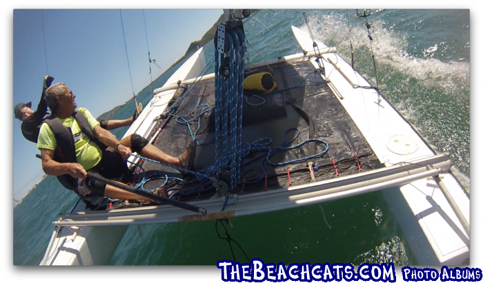

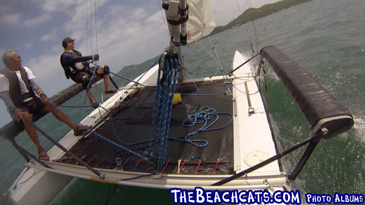

The good news for us is the boat stays parked at the beach. The wings stay on, and flip up for storage. The worse part about them (on land) is how they get in the way while loading the boat with beer and safety gear. My long arms come in handy.
We rigged simple footsteps using adjustable kayak tiedowns inside 3/4" foam insulation. Worked perfectly. They go on and off the boat in seconds.
On the water, we don't seem to be paying much of a price in performance. Wings make it so easy to shift our weight around, that our overall trim has probably improved.
It is so effortless to stand up and move around the 18-2 now that we tend to try out a lot more positions.
Some other plusses:
icon_biggrin More comfort and less fatigue. (I don’t have to sit on a traveler or daggerboard all day, bang my knees up or tear my trunks on all the deck hardware).
icon_biggrin Higher perspective and ease of navigation.
icon_biggrin The waterline clearance is good - we have not dragged the leeward wing in the water yet.
icon_biggrin Roll tacking is very effective with the skipper on the windward rear wing position.
icon_biggrin The Trap lines worked well for both crew members, when shifting our weight out over the bench. I really felt secure leaning out with both controls in my hands on several fast runs. My crew was actually standing on the hull, ready to move his weight as needed. I skippered standing up a few times, when running downwind.
Negatives:
icon_frown Getaway wings are not as light as the Nacra versions. They do add weight toward the aft half of the boat but that's only been an issue with cattrax placement so far. The new balance point is likely 1 ft aft of the dagger centerline. I'll experiment and see.
icon_frown You may need to raise your cleating angles to adjust for the higher crew position.
icon_frown Reaching down from the wings to gather up the lines during a tack is an unnatural position for the skipper. (Head lower that butt). The crew could help do this.
icon_frown Metal wings with black tramps can get hot enough to burn, but this usually only a problem on land.
I mentioned I rarely double trap when I skipper, but it seems to be the norm around here, even on the faster winged boats. Our friends put on a clinic yesterday for us, double-trapped WAY out on their 21SE wings. It is their "go to" mode. icon_eek

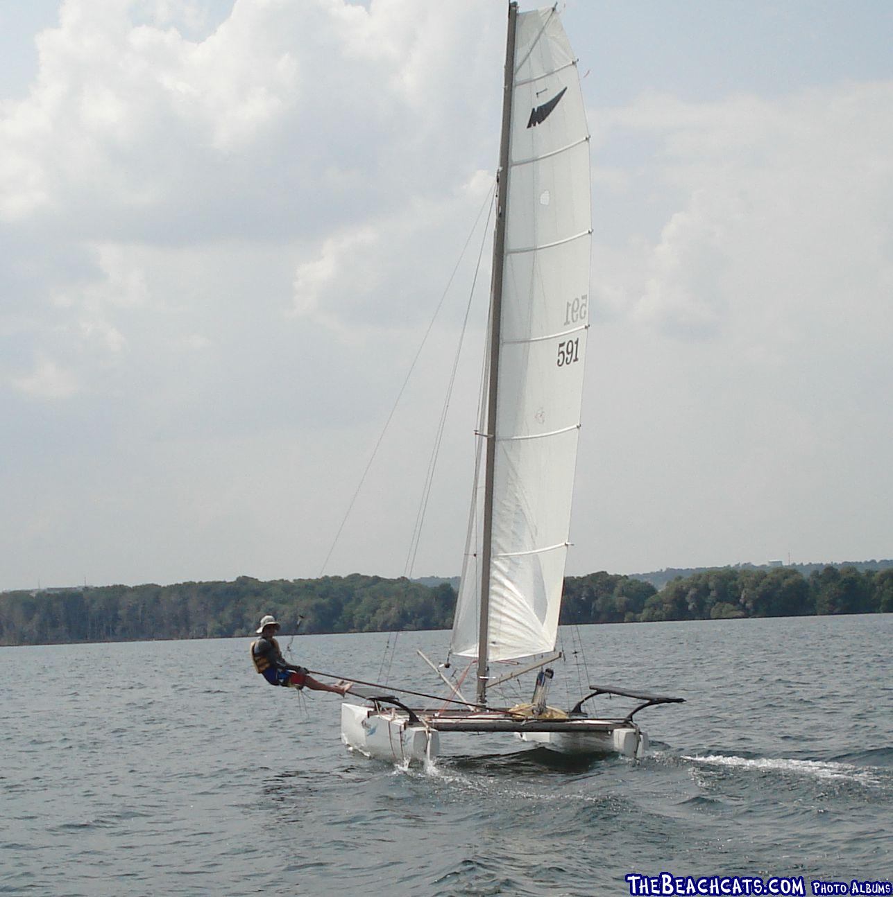

I used to have a Mystere 6XL, (20’ x 10’). It had a set of customized Hobie 21 wings. Made the boat almost 14’ wide. It had double traps, it’s a spooky thing to be that far out when a hull lifts. You only have the 2” pipe to balance on. Lose your footing & it’s a long fall onto the boom or boards.
I used to single hand this beast, with a tramp launched spin. The wings are great, they keep you up out of the spray, & if you were far enough to drag them in the water, you were going over anyway. In contrast my Hobie 18 Magnum will easily drag a wing in the water.
One of the few downsides is reboarding after a swim or capsize. If your not to rotound you can slide between wing & hull.
Another item, rarely mentioned, is the hiking stik. Your normal 8’ stik is not long enough once you are trapped off the wing. On my Mystere, I needed the longest FX stik made.
The photo trapped out is only a 7mph wind, the hull is just kissing the water.

Good point about checking the stick. On this 8'6" beam Prindle with its closer Getaway wings, it may still reach. Sorta.
We'll probably draw straws to see who gets to trap off the back first.

You might enjoy seeing what happens when we got high-sided with both of us out on the wing. icon_eek
https://www.thebeachcats.com/gallery2/main.php?g2_view=core.DownloadItem&g2_itemId=131249&g2_serialNumber=4
We were cruising on a nice reach around 16mph, when a small whirlwind from the nearby flightline crossed our path and suddenly sucked the sails in reverse. You can’t see these devils coming, but the GoPro captured the whole thing.
https://www.thebeachcats.com/gallery2/main.php?g2_view=core.DownloadItem&g2_itemId=131257&g2_serialNumber=4
I’m guessing that if I was out on the wire, trapping normally, I would have been teabagged.

What kind of foam did you use for padding? How thick? How was it beld in place? Cover tension or cement?
I may pad my seats on a new-to-me Getaway.
padding helps a ton for comfort. I may end up with EVA on frame, covered by the tramp material just to have something, especially on long sails. Looking for options for some 1\2 inch to 3/4 inch, closed cell foam. And, will add soft drink holders at same time.

If I’m understanding the physics of load transfer correctly, that would only apply if the wings were free pivoting, supported only by the trap wires.
In order to do this, you would have to modify the wings, by removing the “leg” that goes from the wing to the outer edge of the hull.
I’m not convinced the quote is accurate. If you do a load analysis, say on the wire, yes, the wire pulls on the mast, but the entire forces get transferred to your feet, which are on the edge of the hull.
For wings,your sitting mass wants to pull the big tube upwards,
( pivoting on the smaller leg), but essentially, almost all the load gets transferred to the hull outer edge, via the support leg...in other words, the same as using trap wires to support the wing.
The trap wires are essentially taking some of the load the stays would absorb. You can see this while trapping in a lull, the stay goes slack, the trap wire taking the load.

I made wings from H17 wings for my N5.2. They just slide in the beam ends. After the first big wave with two up I found them to be too flexible and they may have yielded a little. I ended up hooking an adjustable trap wire to the front corner of the seat.
I do not like this setup as it increases the number of wires to plow thru during a pitchpole. I plan to revise my setup to be more similar to the Hobie wings and get rid of the wire.
btw, my current setup is less than 25lbs per wing. Have not measured it yet, but the comfort increase on long trips is outstanding.

Quote"Wing seats are OK as long as you support the outer edge of the seat woth(sic) the trap wires. This way the sailors weight travels
the same path and goes directly to the pressure in the sail, same as if you were trap out without wings."
Probably talking about racing and attempting to minimize the difference between stock boats
we add trap-seats (wings) for comfort and space. been done for decades sans trap wire support.
