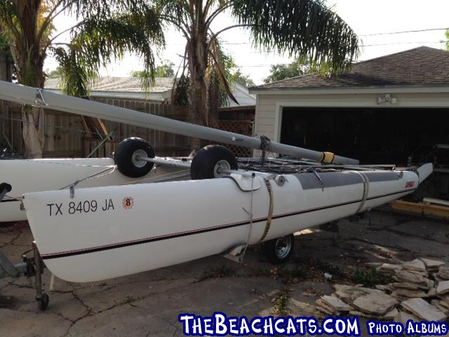

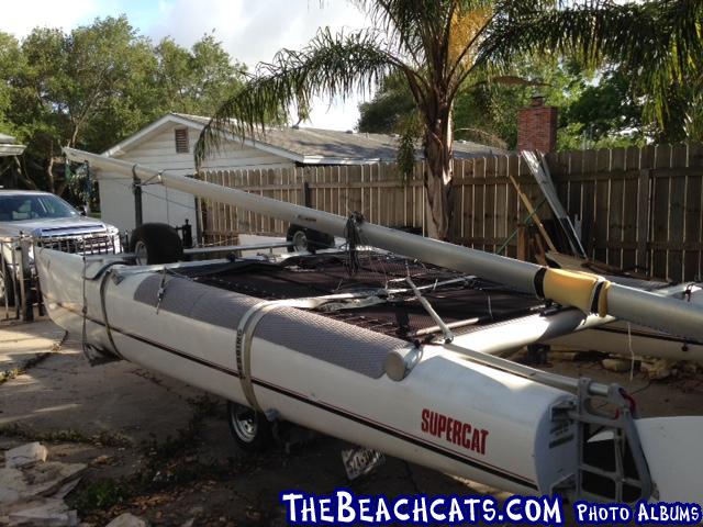

Talk to me about Super Cats. As you guys may or may not be aware, I was given a Prindle 18 last summer, and after lots of work have it sorted out. I have sailed it a few times now, and always have a blast. I just have a few issues with it since it is a family cruiser; the location of the jib blocks on the tramp, the boom, lack of jib furler, and rudders being a bit of a PITA, and to a much lessor extent, the diamond wires.
A Super Cat just came up for sale in the Classifieds that caught my attention. It is boomless, the jib blocks are similar but seem to be more out of the way, it looks to have a roller furler for the jib, and no diamond wires.
https://www.thebeachcats.com/classifieds/catamarans-for-sale/p15191--2789-boston-whaler-supercat-17.html
Considering my purpose is the Super Cat a better fit? Is it a better all around cat?

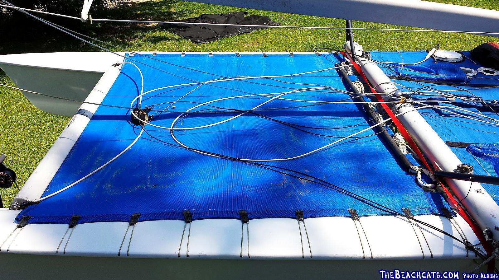

Just to give you something to think about on your Prindle 18, here are some pictures of a "slightly customized" Prindle 18 fitted out as an awesome cruiser.
Including full front tramp, wings, motor mount, and cup holders! Still sailed very well since it really wasn't much weight added.

That's freaking awesome! I want that yesterday!

QuoteIncluding full front tramp, wings, motor mount, and cup holders! Still sailed very well since it really wasn't much weight added.
looks great but like everything on a boat - pros and cons to adding all that stuff
first off: the cup holders - better fit rum drinks or it's worthless! (JK)
but front tramps area great for gear or micro people, but putting weight up there isn't usually good
also windage! wow - that front tramp adds a ton - also that "design" does not allow for anyone to get back on the boat from front (not that i think that's a good place anyway but people still prefer to board from there), nor can anyone easily help feed the mainsail into the track while hoisting
Wings - add weight behind the designed Center of Effort - making the boat a little harder to tack and making weight placement even more critical
so just keep those things in mind when you want to "pimp your cat"
Damon, can you tell us who made that custom front tramp ? Thanks
Yes, that is the question. I'm also curious how he attached the Hobie mast section as a front cross beam.

When we first purchased the ARC 22, the PO had installed a forward crossbeam and net to fill that forward space, as he saw the boat as a cruiser as well. And if that's how you use the boat, fine. But if you plan to ever drive the boat hard in breeze, or have a chance of getting caught out in a building wind, you will quickly discover the downside of the arrangement. The first time we drove the bow under with all that gear up there, it immediately pitchpoled, a thrilling event with a boat this size. We subsequently removed it all, and can now recover quite easily from sticking the bow, as the boat is not slowed so drastically when it goes under. So if you cruise casually in light and moderate conditions, and accept the performance compromises the extra weight of the gear and potentially extra crewmembers extract, it can be great. Do consider using a more open net vs standard tramp material, which creates a bigger windage issue.
At this point my intentions are to use the boat as a family cruiser. I love the water and used to surf a lot. With kids now, I want something to do together as a family.
When I enter it into a race, like the Roughrider Regatta in September, I would remove it all. I will keep your suggestions in mind.

pbegleDamon, can you tell us who made that custom front tramp ? Thanks
I'll try to find out, it was a friend at Ocean Springs Yacht Club, the boat was sold to another member and I think it's still on the beach there.

My SC17 has a triangular forward tramp to eliminate that issue: it runs across the cross beam and tapers to a point at the bridle. Plenty of space for extra gear and foredeck work, and no chance of catching when you dunk a bow. Very nice setup.

https://www.thebeachcats.com/gallery2/main.php?g2_view=core.DownloadItem&g2_itemId=127987&g2_serialNumber=3
https://www.thebeachcats.com/gallery2/main.php?g2_view=core.DownloadItem&g2_itemId=127984&g2_serialNumber=3
Hopefully next Thursday will be the first launch day. Either out in the Gulf or the Laguna.
Cheers!
Jeff

Thanks! I'm going to lengthen the trailer tongue (trailer is for a hobie 16) and add some cradles for the rear instead of rollers. I'm also hoping to build a gin pole to help ease raising the mast. Another option is a mast cradle vertical extension with a pulley for better leverage. I also want to fair the rudders a bit. Its a great catamaran and I'm excited to sail it. Its been too long for me without a beach cat!
Definitely get those rudders faired. They are a huge part of the lift produced by that hull and when the leading edge gets worn down at the bottom they can get out of balance. I have a gin pole setup for the SC17 which you could replicate - I would have to take some pics and measure to get you what you need if interested. In the end I gave up on the gin pole since it takes extra steps and time. I turned the cat around so it's stern first on the trailer, so with the mast in its front trailer support you already have the hard part of stepping done! Get the bottom secured and heave it up from there, using the trapeze lines for lateral stability. Helps a ton, especially if you can park on a slope too.
H16 back in the day
SC17 right now
Bradenton, FL
jdlgcradles for the rear instead of rollers.
I would use it like that first to see if you like it. Rollers on the rear and cradles on the front = single-handed trailering off the beach dolly.
H16 back in the day
SC17 right now
Bradenton, FL
I second keeping the rollers on the rear. It makes things very easy. I haven't loaded mine on the trailer backwards yet, but I may try it soon.
Hobie Getaway
Prindle 18 - Sold
South Padre Island, TX
Reason I wanted cradles on the rear is we have really crappy roads in my town. I dont like the small contact point which results in increased pressure on one spot underneath. I will try it first as is though. Good points.
Im pretty sure i can hoist the mast, Ill just heave it up there the first time and see what i need to change if anything. Launching the boat stern first might be a good option also.
Thanks for the tips.
