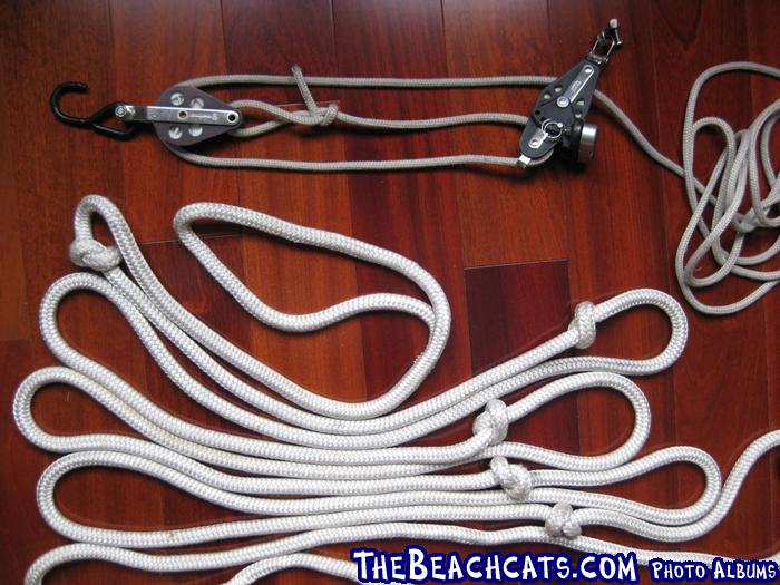

For righting, make yourself a SoloRight. I have the giant water bag and it DOES work, but it's a major pain to use... trying to keep the boat pointed into the wind... stand on the hull, fill the bag, lift the bag (with the blocks and pulleys), lean out into the bag and keep the bag from slipping to one side or another... then hold it steady as the boat comes up... and once the boat starts coming up, the bag is going down into the water losing it's righting weight.... I mean, YES it works, but for me, it's quite a hassle.
Quoteand once the boat starts coming up, the bag is going down into the water losing it's righting weight.
Therein lies the art of righting. You do need to experiment a bit to figure out where on the righting line to attach the bag. To low, & it goes into the drink, losing effectiveness, as you say.
I find that with the bag hoisted to about the middle of my back, by the time the bag touches the water, the boat is far enough up, that body weight alone will continue it on upwards.
We are going to experiment with some righting poles, no one uses the old windsurfers anymore, so I have two masts to butcher, along with a boom from an Invitation.
The quickest recovery I ever did with the bag was 4 minutes. The GPS showed from 30 clicks to 0 in 5 seconds, & 4 minutes later doing 20 clicks again.

I'm definitely going with the furling jib and the 3:1 solo system with the bag, as in the picture posted plus the H14 sail.

I hoist the bag top just above my waist
i get between the waterbag and the hull and lean out (with the line that holds the bag on my shoulder)
this moves / hangs the bag out (and up my shoulder a little)
by the time the bag is hitting the water, the boat mast is at 45* (or more) and i have momentum on my side to finish the last 45*
Quote
QuoteQuote
