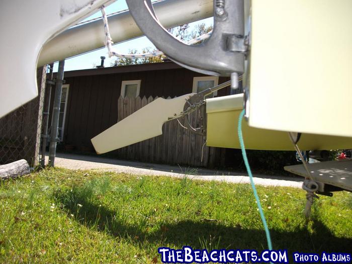

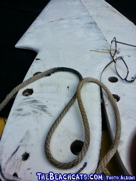

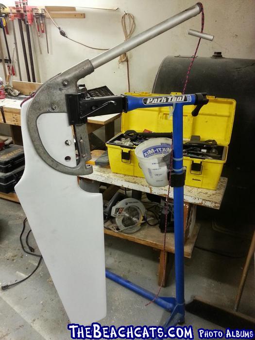

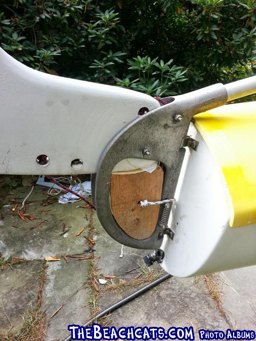

The rudders.............
Old:http://www.thebeachcats.com/gallery2/main.php?g2_view=core.DownloadItem&g2_itemId=103903&g2_serialNumber=4
Updated:http://www.thebeachcats.com/gallery2/main.php?g2_view=core.DownloadItem&g2_itemId=103890&g2_serialNumber=4
http://www.thebeachcats.com/gallery2/main.php?g2_view=core.DownloadItem&g2_itemId=103895&g2_serialNumber=4
The castings really need some cleaning but that will be a winter project. I also found small plastic knobs on ebay for four bucks that will be used for the downhaul line. They are on their way.

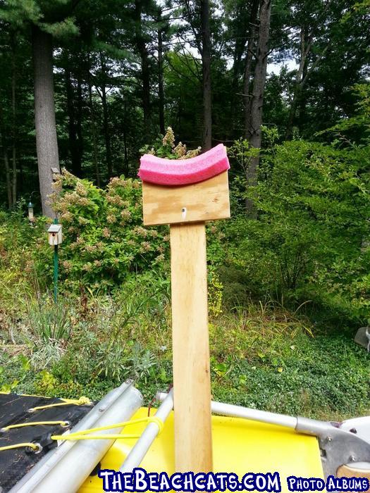

The hiking stick that came with the boat was not in the best shape so I came up with a solution. A $14 painters extender stick. I cut off the end of the original hiking stick and riveted it on the painters extension. Given the rate was snapping expensive hiking sticks twenty years ago, I figured this would be a good cost effective alternative. I saved the original hiking stick so I will have plenty of tubing to build additional sticks :)
http://www.thebeachcats.com/gallery2/main.php?g2_view=core.DownloadItem&g2_itemId=103907&g2_serialNumber=4

Curious how you broke so many hiking sticks? Never broke one in four years of sailing and I have been
knocked over more than a couple of times.
Pete, actually its quite easy :) Usually when I am trapping and I get knocked off by a rogue wave. I'm not smart enough to let go of the tiller and bam, I now have two tillers.

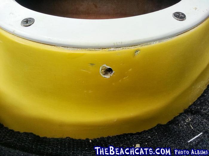

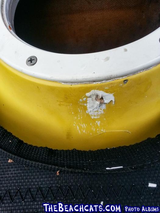

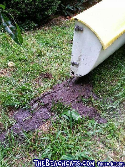

I pulled the plugs, and the rudder brackets, because the guy gooped a pound of silicone over the fittings. Ya, that was fun to take off. Anyway, imagine my surprise when I stuck my finger in there and felt a wall of dirt. Fifteen minutes with a hose cleaned the insides of the hulls quite nicely. So, here is what happens to pine needles after thirty years. Note to self, keep all portholes covers closed.....
http://www.thebeachcats.com/gallery2/main.php?g2_view=core.DownloadItem&g2_itemId=103922&g2_serialNumber=4
I think I lightened the boat by ten pounds.

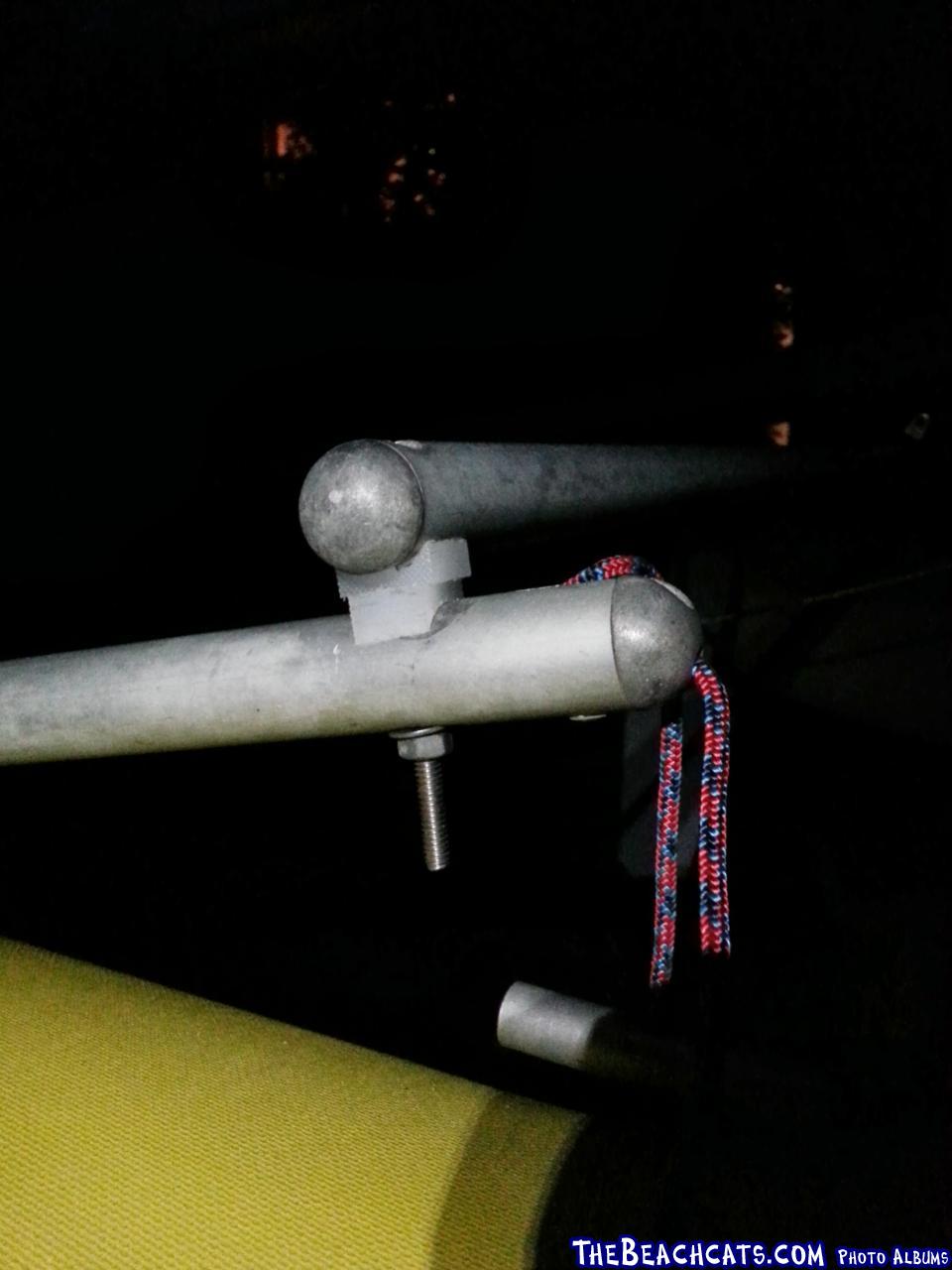

Working on the Jib Cleat pigtails. The galvanized metal wire (not stainless) was epoxied. So I sanded it off and drilled new holes.
http://www.thebeachcats.com/gallery2/main.php?g2_view=core.DownloadItem&g2_itemId=105505&g2_serialNumber=4
http://www.thebeachcats.com/gallery2/main.php?g2_view=core.DownloadItem&g2_itemId=105508&g2_serialNumber=4
I am thinking about swabbing the holes with epoxy before installing the wires.

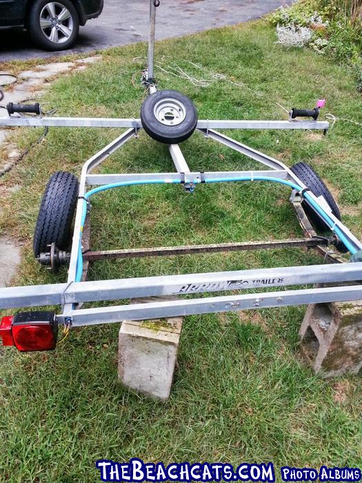

New lights, and wiring. New wheels. Pulled apart hubs, cleaned and repacked them. I soldered all the wire connections and used plastic flexible conduit to give the wires a little protection from the elements. I am so sick of trailer lights that don't work. Hopefully these steps help.
http://www.thebeachcats.com/gallery2/main.php?g2_view=core.DownloadItem&g2_itemId=105513&g2_serialNumber=4
New Prindle 18-2 Owner
Former Prindle 18 Owner
Multiple Hobie 16s
Boylston Massachusetts
peterk123 I am so sick of trailer lights that don't work. Hopefully these steps help.
I share your frustration.
What solved it for me was submersable LED tail and marker lights, soldering all possible connections with a piece of plastic straw on one side so that after it cooled I could slide the straw over the solder and fill it with silicone to keep the water out. I used hose as you did to protect the wires around the wheels and on the tongue connection.

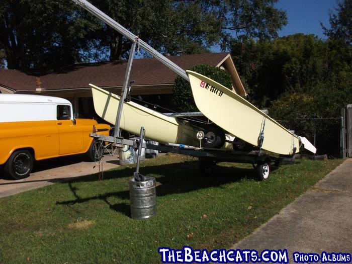

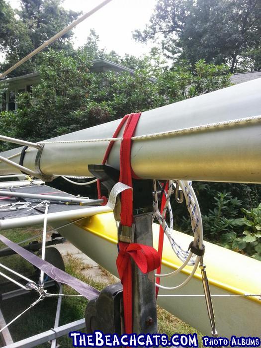

Well, she is pretty much ready to roll. Waiting for the new old sails to show up (thanks again Pbegle) but the original ones are good enough for a test ride tomorrow or saturday. I cannot believe how much work it has been and I haven't even touched the hulls. I spent a couple hours cleaning the mast with a scotchbrite pad and some marine wax. It was worth the effort. I also "manufactured some curved nylon bushings for my tiller. No more slop in the steering :) I need shorter bolts and some lock nuts though; one more Lowes run. Painting project in the plans for the winter or early spring.
http://www.thebeachcats.com/gallery2/main.php?g2_view=core.DownloadItem&g2_itemId=105693&g2_serialNumber=3
http://www.thebeachcats.com/gallery2/main.php?g2_view=core.DownloadItem&g2_itemId=105694&g2_serialNumber=3
Multiple Hobie 16s

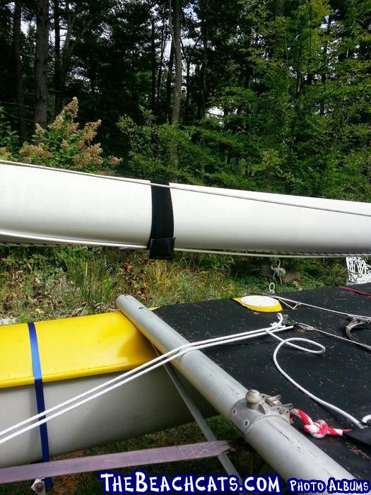

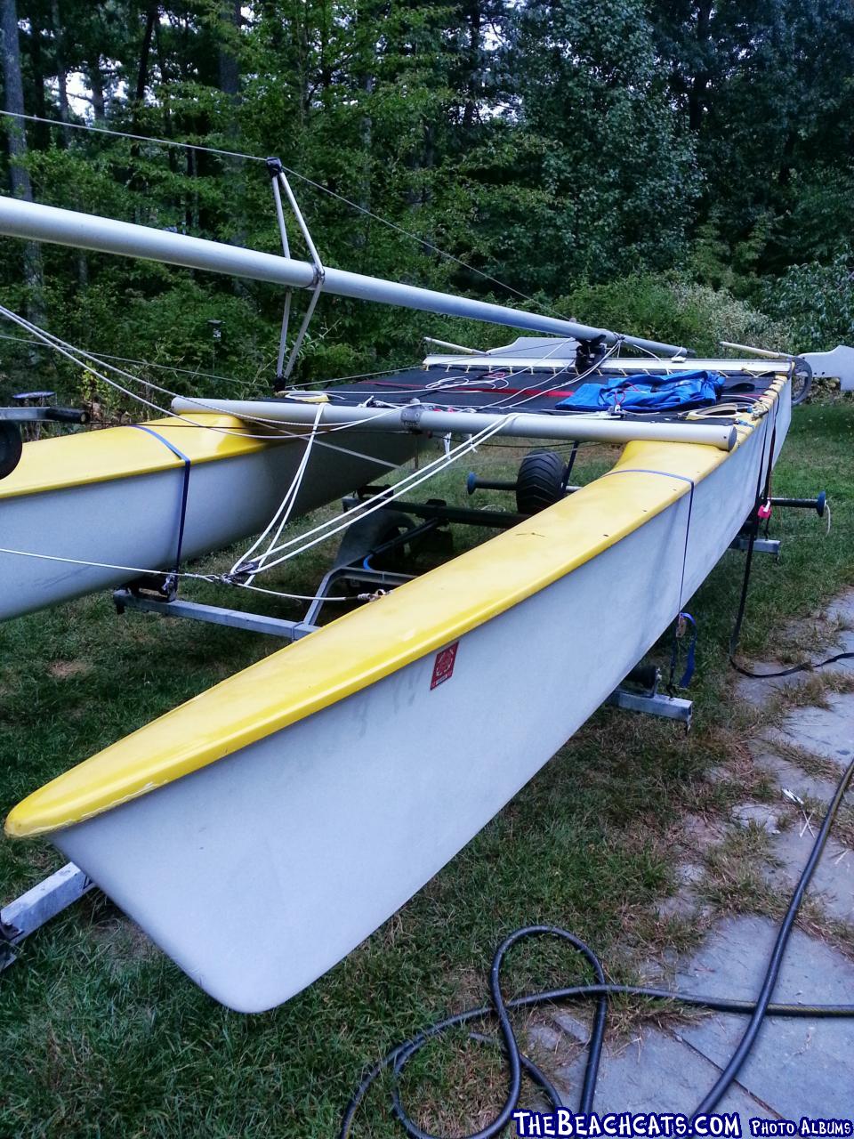

Okay, I promise this is the last set of pics, other than maybe a fully rigged shot tomorrow. I worked on making her travel ready. First was a solution for keeping the rudders on. I stole this idea from someone else. Works good. I made some velcro mast/line straps, purchased some small velcro straps so shrouds could be coiled on tramp, and made the mast trailer happy with proper support.
http://www.thebeachcats.com/gallery2/main.php?g2_view=core.DownloadItem&g2_itemId=105698&g2_serialNumber=4
http://www.thebeachcats.com/gallery2/main.php?g2_view=core.DownloadItem&g2_itemId=105714&g2_serialNumber=4
http://www.thebeachcats.com/gallery2/main.php?g2_view=core.DownloadItem&g2_itemId=105706&g2_serialNumber=4
http://www.thebeachcats.com/gallery2/main.php?g2_view=core.DownloadItem&g2_itemId=105709&g2_serialNumber=4
http://www.thebeachcats.com/gallery2/main.php?g2_view=core.DownloadItem&g2_itemId=105701&g2_serialNumber=4
I am open to ideas to make trailering better and easier so let it rip.

Quote Painting project in the plans for the winter or early spring.
Before you think of painting, do a quick search on Poliglow, a clearcoat finish for gelcoat. Gelcoat is a far harder finish than paint, far more durable and will last for years, Poliglow will renew the gelcoat finish and only has to be re-applied every 2 years. From experience, though, Poliglow does not bring out the high luster shine on white hulls as it does on color, but it still gives the gelcoat that clearcoat protection and ease of cleaning.

I wouldn't travel long distances with the rudders on, your solution looks interesting, but still. In any case, be careful not just on the highway but particularly on small roads and short distances, where you will tend to relax with the tying.. I broke the tiller crossbar like that, I touched some light bushes on one side and it went all the way. I was going very slow and the bushes seemed light enough, but I wasn't thinking about the tiller.. once it moves to the side a little bit, it goes deeper into the bushes very quickly.
QuoteI wouldn't travel long distances with the rudders on,
....I agree, remember, with the rudder at right angles, there is now more weight acting on the gudgeons and pin, and with any bump all that force is doubled, even trebled. Even though you have the block inserted to stop the rudder from bouncing, all that force will now be acting on the pins/gudgeons.
DeuceSoldering is definitely the way to go
Thread a 4" piece of thick plastic straw over one end before you solder. Use silver solder. Move the straw back over the joint and seal both ends with silicone seal.
the-renovatorEven though you have the block inserted to stop the rudder from bouncing, all that force will now be acting on the pins/gudgeons.
Your rudders will get sloppy quickly if you trailer them this way, and it is a lot of work to fix it.
Take your rudders off at the pintles- yes both rudders and the crossbar- fold and store them in your cat box when trailering.

What I do is remove the rudder from the casting, I have teased the knots on the rudder lines loose,where the lines terminate inside the rudder. I remove the pivot pin with an 11mm wrench, loosen the 2 knots on the rudder lines and remove the rudders, insert them into their protective covers and stored in my gear-box for transport, the lines are tied together with a simple slip-knot to secure. When I install the rudder, a simple over-hand knot is used when the rudder lines are re-inserted, they loosen easily when needed, sometimes I have to use pliers to coax them loose. Takes me an extra 5 min to install rudders but saves on wear & tear when trailering. I am a trailer-sailor, nearest lake to me is over 1hr driving.
