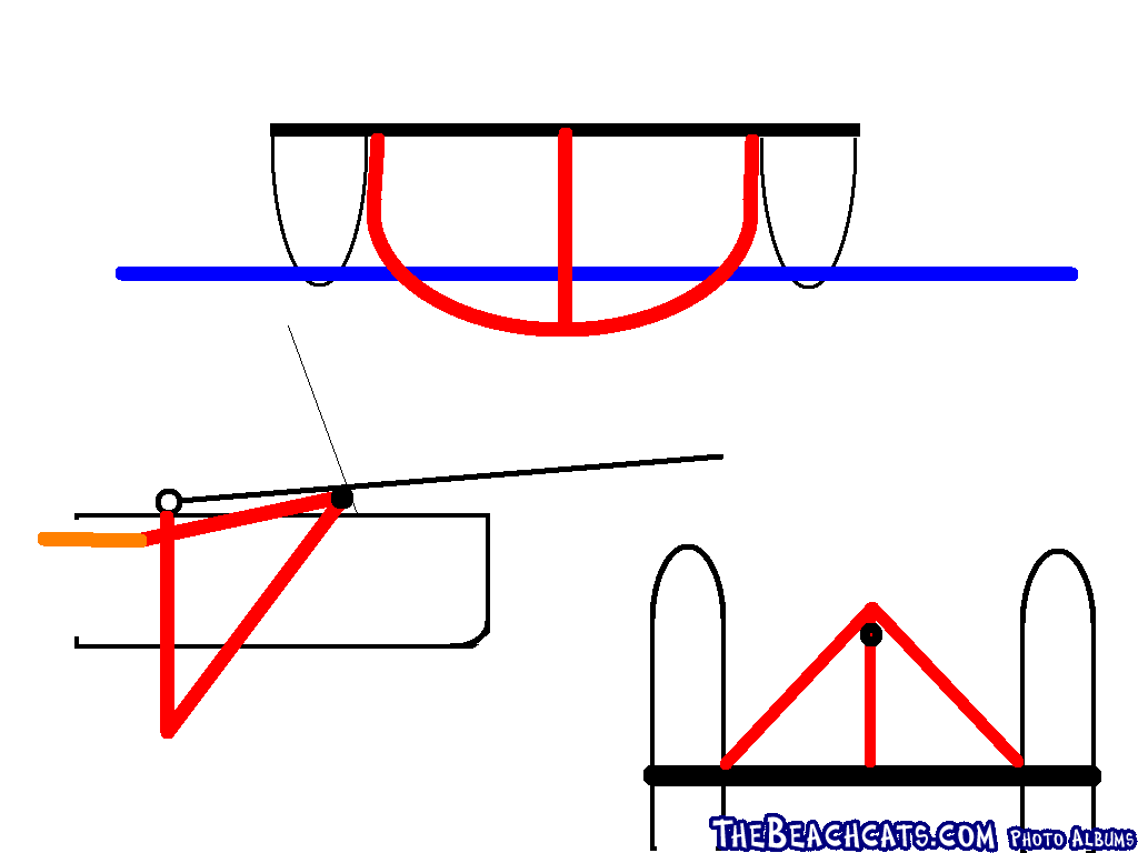

An elderly skipper at the cat-club (67), showed me his setup how to climb on board.
He tied a 12 mm line to the front crossbar hull to hull, the slack on the line is just deep enough in the
water to put a knee or foot on it , while you're in the water.
When you try to climb onboard this line will go under the tramp and is not very helpful.
Now here's the smart-part, he braided another line to center of the boarding-line, ran it through a block
attached in the center of the bridle for the forstay. Tied a stopper-knot behind the block to prevent the
boarding-line from going under the tramp.
The stopperline is braided to a shock-cord witch is ran under the tramp, it keeps the whole setup out of
the water while sailing.
Here's a drawing,
http://www.thebeachcats.com/gallery2/main.php?g2_view=core.DownloadItem&g2_itemId=100983&g2_serialNumber=3
Fiddled a bit with line-lenght on my P18-2, and now it works perfect and makes my wintersailing-project
a lot safer.

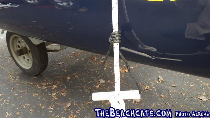

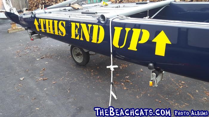

I needed to replace my righting line. Looked around for appropriate size line and found it more than $1 per foot. Went to West Marine and found a 25 foot nylon double braid line with a 12" eye splice in one end, cheap with a coupon.
Back on the cat, I tied three half-grapevine knots on the line, spaced to be used during righting, and set the overal length so that the eye splice was just in the water when the cat is on its side. My foot goes in the loop and I use the knots to pull myself up, and the hull over. Car manufacturers and stereo installers use a coiled plastic wrap to manage lots of wires together into a bundle. I used 4" of that same stuff to hold the eye splice open into a step. Otherwise the loop just closes when wet.
Usually my crew is on the bottom hull as the top one comes down, and so climbs to the deck of the hull as it rotates. If he gets left in the water between the hulls, I wrap the righting line around the mast base a few times and drop the foot loop in the water for him to use to climb back onboard.
If you can make your own line, you could incorproate a curved piece of PVC or electrical pipe to form the foot loop, just make sure it is small enough to fit into your tramp pocket.

Tom, I am working this weekend, so will make some pics next week, cat is not in my backyard.
the drawing should explain most of it. So if your cat is in the backyard, fiddle around with some
lines and a block attached to the bridle .

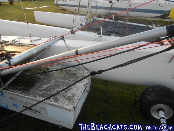

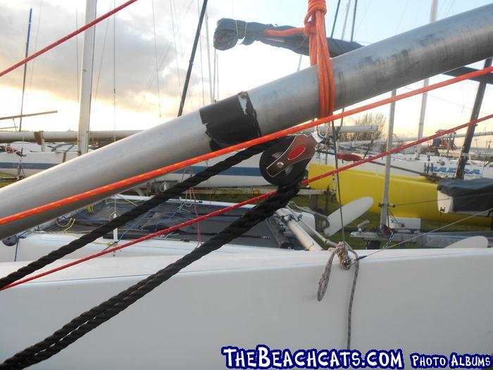

Guys, made some pics and a video, yes it is crappy, but it is a life saver!!
http://www.youtube.com/wa…&feature=player_embedded
http://www.thebeachcats.com/gallery2/main.php?g2_view=core.DownloadItem&g2_itemId=101003&g2_serialNumber=4
http://www.thebeachcats.com/gallery2/main.php?g2_view=core.DownloadItem&g2_itemId=101006&g2_serialNumber=4
http://www.thebeachcats.com/gallery2/main.php?g2_view=core.DownloadItem&g2_itemId=101000&g2_serialNumber=4
Regards, André

will the setup work just by adding a block to the bridle.. seems like it would pull the bridle back
carl2
here are my thoughts on this set up:
Yes it will pull your bridal back
i personally don't think it's a good idea to do that
having just replaced my bow tangs. i now know, I don't want any pressure from any direction except as intended
i believe the OP's set up took most of the load on the beams... that is a good place for load
no disrespect intended but I'm not a fan of that line hanging down either... if your line ever worms itself free... you now have a line dragging from a bad location. even in medium wind, tacking can be pretty violent place to live (if your a line tied to a forestay/jib)

Here is how you tie the Prusik knot:
http://www.animatedknots.com/prusik/#ScrollPoint

dmgbear55I'm glad this topic came up because as a very full figure kind of guy I know how hard it can be to get back up on deck, particularly when you become exhausted. I had this idea a while back and just went out to the shop and spent less than 10 minutes making this addition to my righting line.
Be sure and report back after you have tried it on the water. Usually the problem with anything like a "rope ladder" is that there is nothing to push "inward" against, only down, so it just swings out of the way.
Try it and see how it goes.

QuoteBe sure and report back after you have tried it on the water. Usually the problem with anything like a "rope ladder" is that there is nothing to push "inward" against, only down, so it just swings out of the way.
Damon, I think you are right about a rope ladder per se, but in this case at least one of the loops should be against the hull, in fact they both could be. With the Prusik you can adjust the loop height on the righting line as needed. Still probably a little tricky but manageable. This End Up is about to get splashed so will report the results then. If you were sailing with crew you could also get them to stand/hold the position of the lower loop.
QuoteNot really sure how to feel about all of this info. Just got back into Cat Sailing in April of this year and have yet to flip it. Guess I should at least manually flip it over in something other than the Ocean and make sure I won't have too many issues.
I agree with you, but being a little prepared in this regard could make a bad day sailing be just that and nothing more.

http://www.thebeachcats.com/gallery2/main.php?g2_view=core.DownloadItem&g2_itemId=126006&g2_serialNumber=4
http://www.thebeachcats.com/gallery2/main.php?g2_view=core.DownloadItem&g2_itemId=126009&g2_serialNumber=4
Many are in favor of climbing from outside the hull, as with this system, but how hard is to get there? Do you have that experience in tough conditions and with the boat moving? If there are waves the hull may slam your head when crossing to the other side. And on the other side, if you miss the line (or don't have it as in other cases), where do yo grab from? The cat in some cases may start moving rather fast, that's when I realized I needed some aid from under the beam.
This ladder system could perhaps go on the inner side of the hull, with a carabiner and an eyestrap on the beam. Ideally set up before righting, to have it ready (except that you would have to pull it back to the other side of the hull)
I see also that you tie the righting line to the mast rod, I've always felt that this may bend the rod if it pulls from the wrong end. I prefer to tie mine around the beam, through a grommet on the tramp. It goes around the rod too, so you don't pull from the grommet. My mast rod got bent once when I passed over a buoy with a carabiner that hooked on the dolphin striker. Not good.
carl2http://www.thebeachcats.com/gallery2/main.php?g2_view=core.DownloadItem&g2_itemId=126004&g2_serialNumber=3
The force applied when stepping on the line is nothing compared to the forces to hold the mast while sailing.
The shock cord will pull back when not in use but what harm can that make? It will move back maybe 1 or 2 cm in light wind, and nothing in stronger wind.

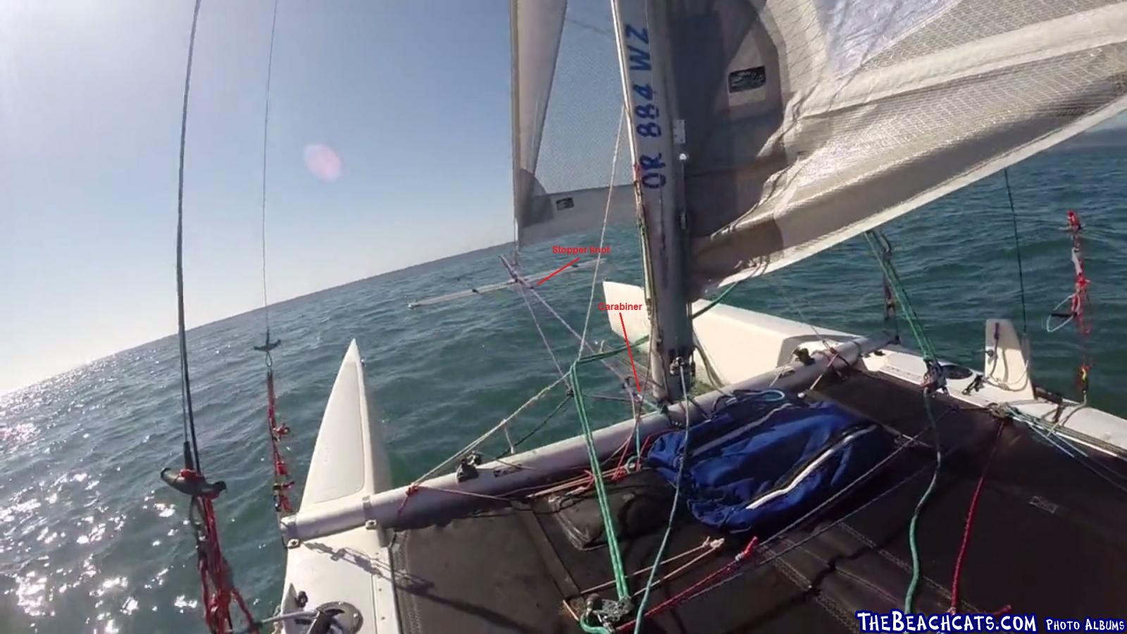

I don't use a shock cord to keep the line up but a carabiner to the center of the from beam. (carabiner hooks to the righting line loop around the front beam/mast step rod). The line doesn't end at the carabiner but is longer, the rest is stored on the tramp pocket. It is also my towing line, I just unhook the carabiner and throw it to the towing boat or to attach to buoy, etc.
http://www.thebeachcats.com/gallery2/main.php?g2_view=core.DownloadItem&g2_itemId=126000&g2_serialNumber=3
Edited by Andinista on Nov 12, 2016 - 08:39 AM.
In the case of my boat I would probably make sure that the righting line was pushed up close to the bottom of the beam before loading it up during righting to avoid bending the DS. Tying it in the center means it is ready for use from either side of the boat. I also don't think it would be a good idea to tie the righting line off on top of the beam fearing that the mast rotation could get messed up, or it would eat into the righting line.
I think you could sort out ways to do the same sort of thing from the inside but I was shooting for very simple system without adding many other elements to the boat. I also think Damon's point about rope ladders is very valid here. I just wonder if just one loop close to the bottom of the hull would actually do the trick, giving you just the leg up that you need.

Here si a simple idea: righting line is as in your picture, grab it from below the hull and thread it around the beam on the hull end, make room for your foot, there's your step. Ir keep the loop for the foot if you wish. Keep the two ends of line around the beam on your hand, friction should keep it there i think
