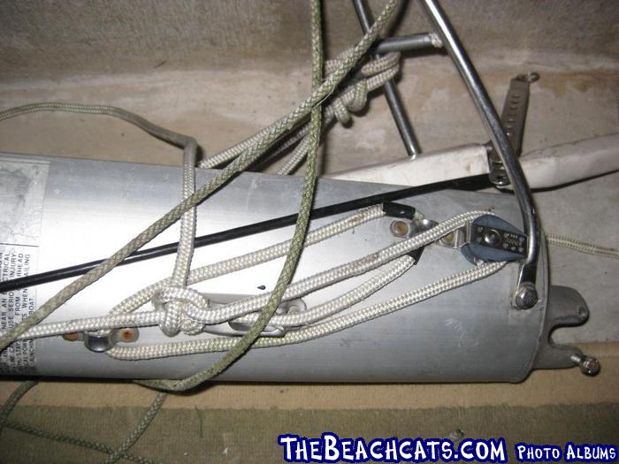

My 5.0 had the old style base. It was riveted on with three rivets. After drilling out the rivets, it just slide off. I put on the captive ball mast base, but it did not fit over the enter base. To seal the mast, I put styrofoam in the base and sealed it with silicon. Did anyone else run into this ? Did you leave the bottom open and seal everything above the base? Did the base of the mast change in later years to account for the new casting shape? Here are the old and new bases. https://lh3.googleusercontent.com/-GFBG7EWNx0k/TJAX2c797XI/AAAAAAAABC4/RTKhJXijgTI/s400/CRW_6895.jpg https://lh6.googleusercontent.com/-FGd6UvvrFLY/TJAX2cXUNFI/AAAAAAAABC8/XiA0uSf5jTU/s400/CRW_6897.jpg https://lh6.googleusercontent.com/-KvR_-LuvJ80/TJAX3K1h7lI/AAAAAAAABDE/W4I6hR16FUk/s400/IMG_2904.jpg

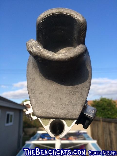

bh3700 Did the base of the mast change in later years to account for the new casting shape? Here are the old and new bases.
From your pictures it looks to me like they just eliminated the part of the mast base that covered the sail track, but the mast base still covers up and potentially seals the interior of the mast. That design could make it easier to install things like down-hauls that slide up into the track.
Just guessing based on your pictures.
As Damon said, the extrusion is still the same, the base looks like a different shape, but my understanding is that only the little "pointy end" was removed on the captive base.
You don't need to seal the portion where the old base covered the sail track, only the main section. The new style base should slide into the extrusion, just like the old one came out.
I have one of the lower rivets on that small eye strap left unsealed, with a small plastic "stick" pushed into the hole. I put the stick in while sailing, & pull it out (tie to a string to prevent loss) when done, to allow any water to drain.

I see what bh3700 is saying, as Damon mentioned, the new style mast base has the piece that would have covered the base of the sail track removed, that would leave 2 small holes on either side of the sail track uncovered. Look closely at pic 1 with old base semi-removed, you can see the inside edge of the sail track, if you draw a straight line from either side of outside edge of mast circumference, it will leave 2 small triangles on either side of sail track uncovered, look at the foam plug inside the mast behind the base, makes a good indicator. Do as flyingfishguy did, seal holes.

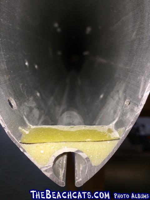

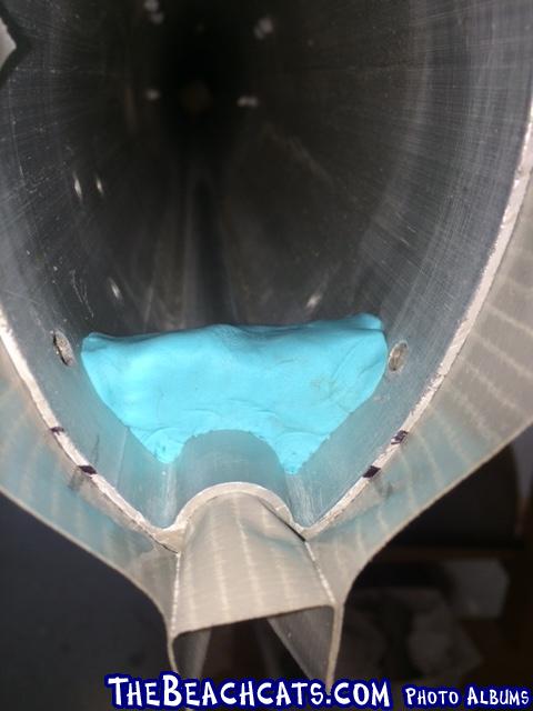

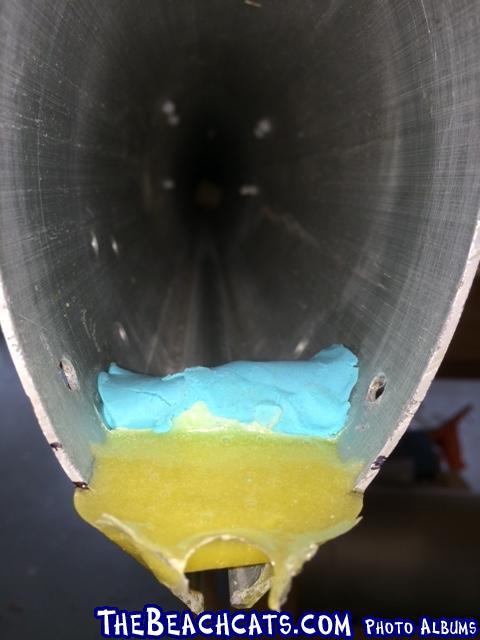

I know this is an old thread, but I recently addressed the situation where the mast base casting leaves two small triangular gaps. I began by cleaning and roughing up the inside of the mast extrusion where the triangles are. I then built a dam out of duct tape and some blue play-doh I stole from my kids.
https://www.thebeachcats.com/gallery2/main.php?g2_view=core.DownloadItem&g2_itemId=127928&g2_serialNumber=3
I then filled the area with West epoxy and flox.
https://www.thebeachcats.com/gallery2/main.php?g2_view=core.DownloadItem&g2_itemId=127936&g2_serialNumber=3
After it dried I trimmed the excess with a saw, ground things the rest of the way with a grinder, and then finished up with 150 grit on a sanding block.
https://www.thebeachcats.com/gallery2/main.php?g2_view=core.DownloadItem&g2_itemId=127937&g2_serialNumber=3
The final result seems much better than the giant boogers of silicone that were there before.
https://www.thebeachcats.com/gallery2/main.php?g2_view=core.DownloadItem&g2_itemId=127938&g2_serialNumber=3
