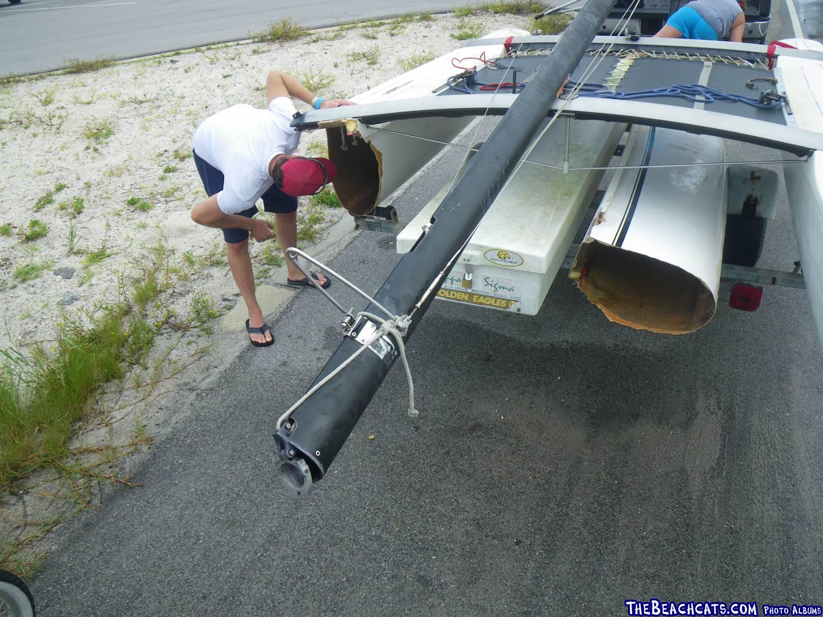

Forgot I was going to add to the thread collection of broken H18's with this one. Oh my gosh it's another white one, I think you may be on to something.
http://www.thebeachcats.com/gallery2/main.php?g2_view=core.DownloadItem&g2_itemId=65842

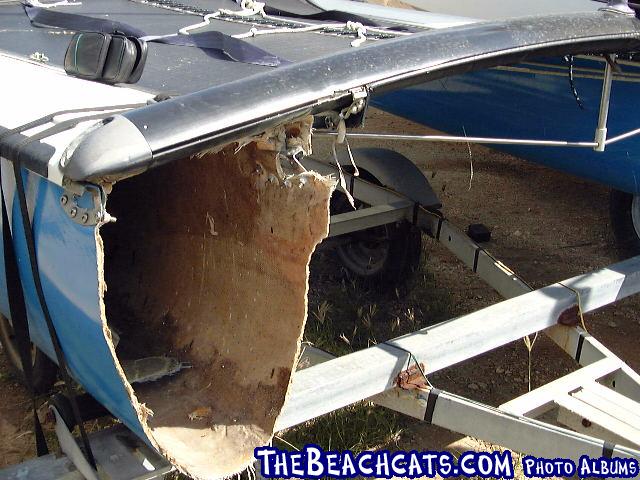

Oops, I guess the "beachcats of color" can fail too, just found this.
http://www.thebeachcats.com/gallery2/main.php?g2_view=core.DownloadItem&g2_itemId=30466
Ouch! That one had the reinforcement plates as well. Perhaps no internal patching though. Do you happen to know the story on that one?
