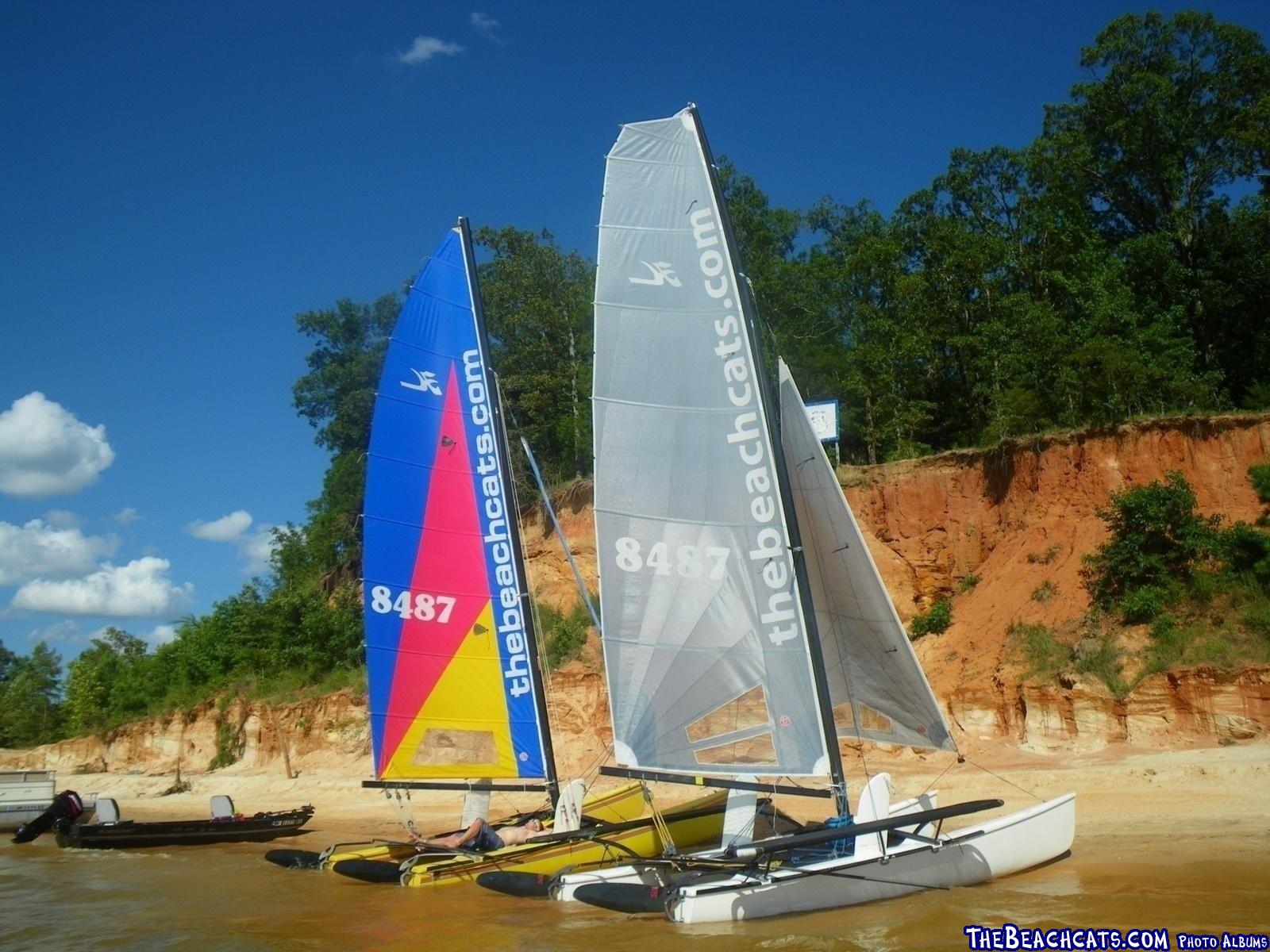

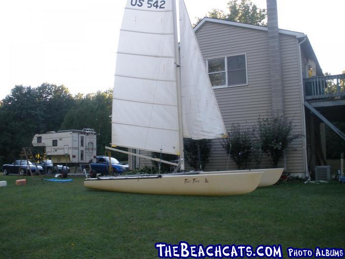

FYI, some cats have fixed mainsail, when the mainsail is attached to the boom by sliding the foot of the sail into a track on the boom, the foot is fixed, ie H16
http://www.thebeachcats.com/gallery2/main.php?g2_view=core.DownloadItem&g2_itemId=81603&g2_serialNumber=4
When the mainsail is attached to the boom by securing the clew of the sail to an outhaul car on the rear of the boom, it is "loose-footed", ie Tornado, Prindle, etc.
http://www.thebeachcats.com/gallery2/main.php?g2_view=core.DownloadItem&g2_itemId=90926&g2_serialNumber=4
http://www.thebeachcats.com/gallery2/main.php?g2_view=core.DownloadItem&g2_itemId=80155&g2_serialNumber=3
HTH
R
