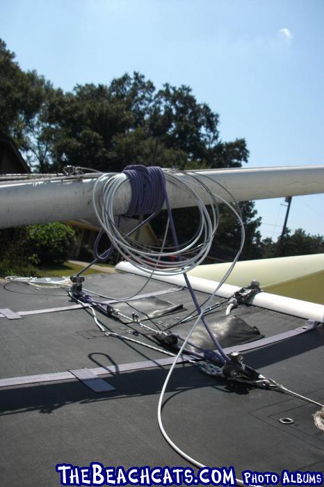

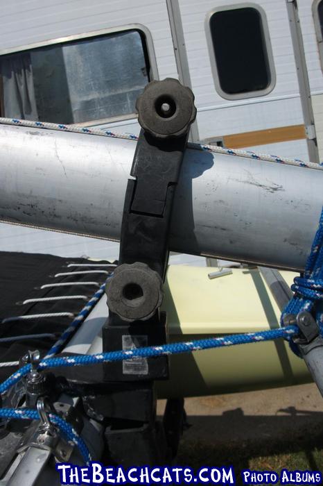

i use nitrodubs method...i drive 70 miles each way to the coast with http://www.thebeachcats.com/gallery2/main.php?g2_view=core.DownloadItem&g2_itemId=76764&g2_my p-16
here is how i secure the mast/tiller crossbar...http://www.thebeachcats.com/gallery2/main.php?g2_view=core.DownloadItem&g2_itemId=76769&g2_
here is how i deal with the rigging/jib sheethttp://www.thebeachcats.com/gallery2/main.php?g2_view=core.DownloadItem&g2_itemId=76777&g2note forestay pinned to mast base

I simply remove the long rudders pins the connect them to the hulls like said above and remove the entire rudder setup as one piece. I loosen the the rope keeping the rudder up just bit so the rudders can fold parallel to each other tie a line around em and toss em in the catbox. I can remove or install them in less than 5 minutes even by myself. It really is not that hard. My wife has even beaten me to the last couple times doing by herself or with one of sons. It really is quite easy and not that time consuming at all one you have done it a couple times.
QuarathI simply remove the long rudders pins the connect them to the hulls like said above and remove the entire rudder setup as one piece. I loosen the the rope keeping the rudder up just bit so the rudders can fold parallel to each other tie a line around em and toss em in the catbox. I can remove or install them in less than 5 minutes even by myself. It really is not that hard. My wife has even beaten me to the last couple times doing by herself or with one of sons. It really is quite easy and not that time consuming at all one you have done it a couple times.
Same here. Just make sure the threaded portion of the cross bar is marked so the rudders aren't out of alignment. If they are it is pretty easy to tell as soon as they are hung, just a PITA to have to take it back off and fix it.

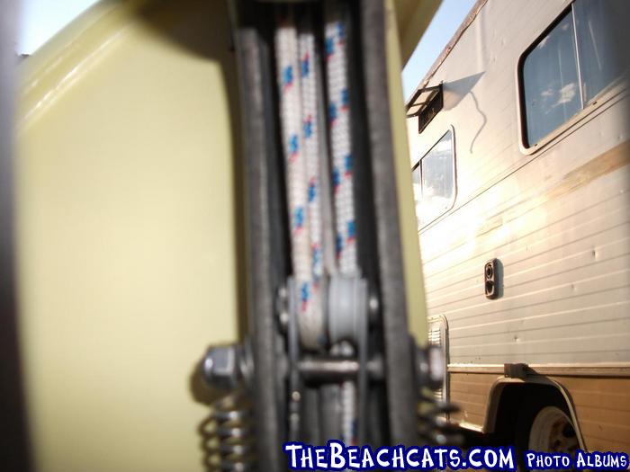

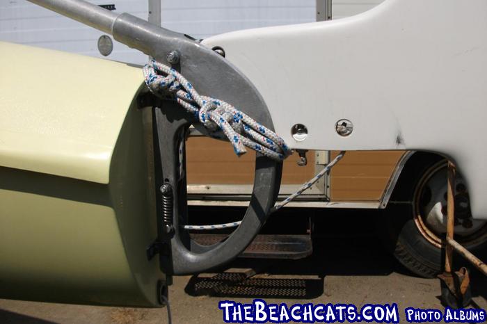

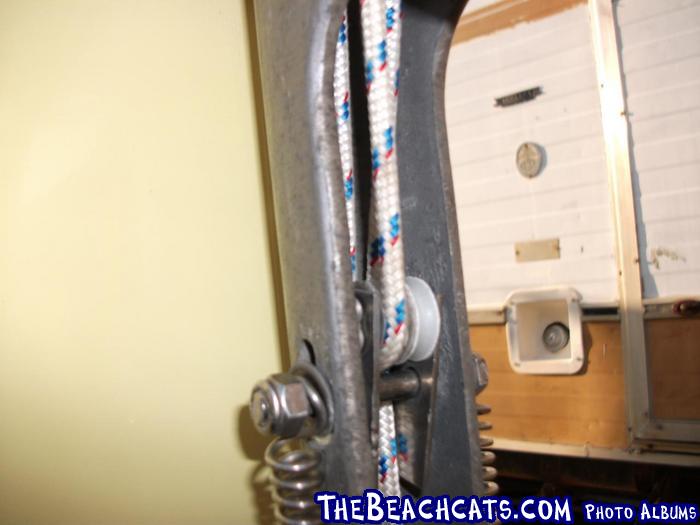

So when I went to order the new rudder sheaves, hit a problem, on my rudder setup there are 3 upper sheaves, 1 lower sheave on the lock release plate. Murrays did not know about this lower sheave, they say that according to their catalog, there is no sheave, only a plastic spacer. So the question is, is my lower sheave an upgrade, or is the plastic spacer an upgrade?
I like the sheave there, it has a small spacer on the side of the sheave, on the clevis pin, it acts as a rope guide as well as giving me 2:1 uphaul on the rudder.
What thinks thee my merry men?

So when I went to order the new rudder sheaves, hit a problem, on my rudder setup there are 3 upper sheaves, 1 lower sheave on the lock release plate. Murrays did not know about this lower sheave, they say that according to their catalog, there is no sheave, only a plastic spacer. So the question is, is my lower sheave an upgrade, or is the plastic spacer an upgrade? Which would be better?
I like the sheave there, it acts as a rope guide as well as giving me 2:1 uphaul on the rudder.
What thinks thee my merry men icon_confused

i tried to get a tight shot of my rudder...http://www.thebeachcats.com/gallery2/main.php?g2_view=core.DownloadItem&g2_itemId=76955&g2
Bill, you have 2 sheaves on your lock release plate, waddup wid dat icon_confused

you can use sheaves as a spacer like coastrat "nice rudders by the way".upper & lower sheaves look to be the same,that is probably why murrays doesnt bother to list a lower sheave. maybe just order 5 sheaves per side or 4sheaves w/ a spacer per side.
Have 8 sheaves on order, Tom at Murrays ran out to take a look at a P18 they had on site, he said there was no lower sheave on that one, it had the new spacer which does away with the lower sheave, it's longer than the old spacer.
